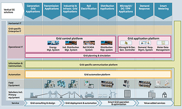

A secure, reliable and economic power supply is closely linked to a fast, efficient and dependable communication infrastructure. Planning and implementation of communication networks require the same attention as the installation of the power supply systems themselves (fig.1).
Telecommunication for utilities has a long history in the transmission level of the power supply system and Siemens was one of the first suppliers of communication systems for power utilities. Since the early 1930s Siemens has delivered Power Line Carrier equipment for high-voltage systems. In today’s transmission systems, almost all substations are monitored and controlled online by Energy Management Systems (EMS).
The main transmission lines are usually equipped with fiber-optic cables, mostly integrated in the earth (ground) wires (OPGW: Optical Ground Wire) and the substations are accessible via broadband communication systems.
The two proven and optimal communication technologies for application-specific needs are Synchronous Digital Hierarchy (SDH) and Ethernet.
Fiber-optic cables are used whenever it is cost-efficient. In the remote ends of the power transmission system, however, where the installation of fiber-optic cables or wireless solutions is not economical, substations are connected via digital high-voltage power line carrier systems.
Figure 1 - Complete communication network solutions to build a Smart Grid for power utilities
Figure 1 – Complete communication network solutions to build a Smart Grid for power utilities
