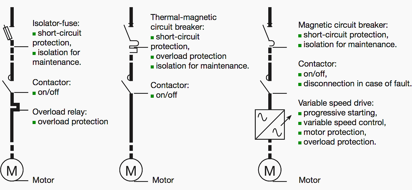

Motor starter design and functions
Recommended solutions
Conventional motor protection systems based on thermal overload protection cannot communicate with higher-level process control systems and consequently fail to meet the needs of today’s continuous process industries.
This is due to several factors //
First, motor failure can be triggered by a variety of incidents, such as an abnormal power load or supply, an insulation failure, incorrect wiring, or a number of external factors. Such incidents can cause motor burnout or other problems, each requiring a different response.
Conventional motor protection systems with a “circuit breaker + contactor + thermal relay scheme protect only against short circuits and overloads—but these account for a mere 35% of motor failures. Therefore, conventional systems are clearly unable to ensure service continuity for critical processes.
Second, protecting a motor by simply shutting it down is often impractical. Today’s plants need intelligent motor protection systems that can identify potential risks and alert operators to take action before a failure occurs.
Third, motor protection systems must communicate with both process and power SCADA systems.
