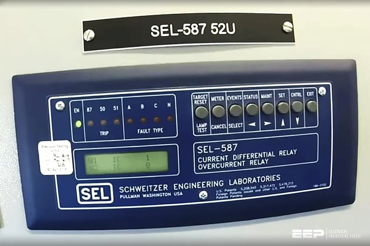

This project simulates protected system that includes a source, circuit breaker, transformer, and motor. Schweitzer Engineering Laboratory’s (SEL) protection relays are used to open breakers during fault conditions on transformers (SEL 587) and motors (SEL 710).

First, analysis was done on each of the individual components to test for functionality. Testing the transformer and motor separately provided the relay and circuit breaker coordination during fault conditions. The motor was protected against phase-to-ground, line-to-line, locked rotor, and temperature faults.
As for the 3-phase transformer, the SEL 587 protected against phase-to-ground, line-to-line, and 3-phase faults.
When integrated, the system will run during normal conditions and protected during fault conditions with the use of SEL relays and Cal Poly circuit breakers. Each of the relays is responsible for detecting the fault in 5 cycles and opening the local circuit breaker. The circuit breaker operation was controlled using programmed logic functions within the SEL relays.
