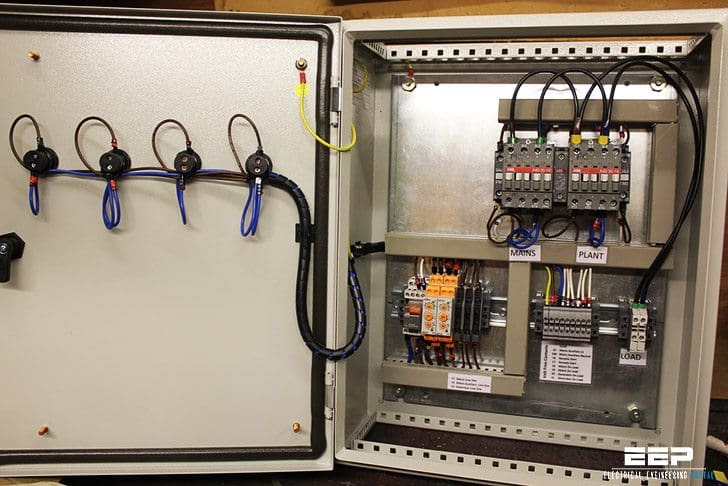

Guide to manual and automatic transfer switch equipment and operation (on photo: Automatic Transfer Switching ATS & AMF Emergency power is transferred automatically from one supply to another if it be a GENSET or 2nd mains supply via one or more load circuits, either manual or motorized. When the original supply is restored, the system automatically changes back; credit: Blades Power Generation)

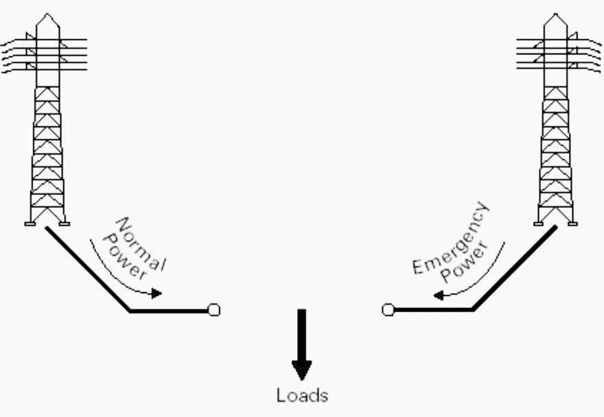

Normal And Emergency Power Provided By Utility
An additional emergency service from the utility would have to come from a source separate from the utility’s normal supply.
This requires additional equipment and lines from the utility. In addition, the normal and emergency lines would probably come from different supply locations to reduce the possibility of losing both power supplies at the same time due to the same condition, like a thunder and lightning storm.

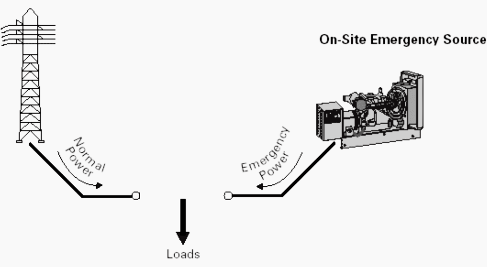

Generation of emergency power using gasoline or diesel engine-generator sets on-site is the most common method utilized for standby power systems.
Normal Power Provided By Utility And Emergency Power Generated On-Site

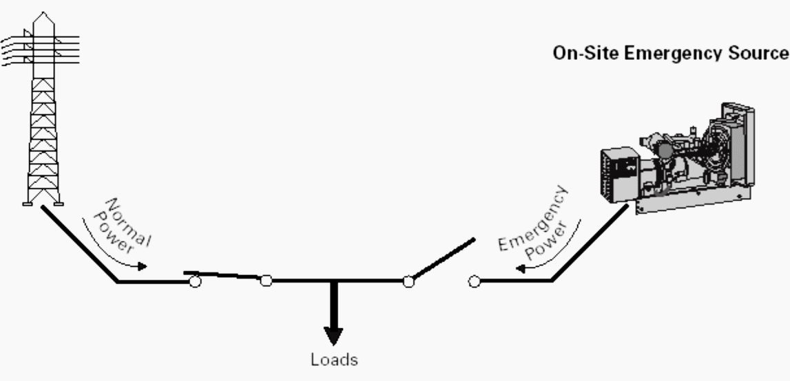

Whether the utility provides both power sources or emergency power is generated on-site, a means must be provided to transfer the load circuits to the available source. Transfer switch equipment provides a means to quickly and safely transfer the critical load circuits, and is the primary topic of discussion of this guide.
Typical Emergency System With Transfer Switch Equipment
