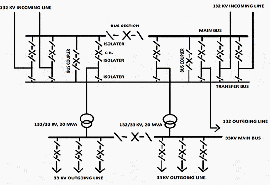

The project work assigned to us was to design a 132/33 KV EHV substation. We considered incoming power at 132 KV and the power was transferred to main bus through isolator-circuit breaker-isolator combination.

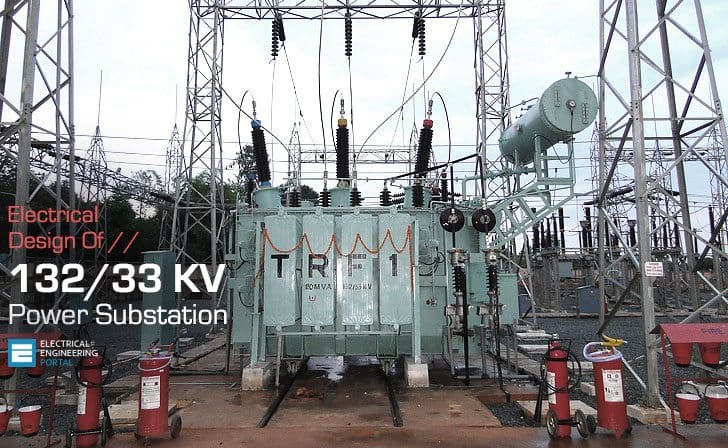

Electrical Design of 132/33KV Substation (on photo: Construction of 132/33kV Substation
Electrical Design of 132/33KV Substation (on photo: Construction of 132/33kV Substation at Umerkote; credit: selindia.net)
The power from main bus was fed into a 20MVA transformer which stepped the voltage down to 33KV.
The power is then fed into a 33KV bus from which different loads were tapped. In the process, the surge impedance loading of 132 KV and 33 KV lines were calculated and they were used to estimate the maximum power that can be transferred by one transmission line.
The design of the entire substation was made keeping in mind the most basic requirements of a proper substation including the civil and domestic requirements.
132-33 kV substation single line diagram
