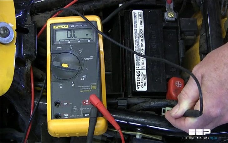

Using digital multimeter for testing of automotive charging system (photo credit: Rick's Motorsport Electrics via Youtube)
Perhaps the most important tool you’ll use in troubleshooting auto electrical systems is the multimeter, usually digital.
Basic multimeters measures: voltage, current and resistance, while more elaborate multimeters, such as for example the Fluke have features that can check things such as frequency, duty cycle, dwell, make diode tests, and even measure temperature, pressure and vacuum.

Charging system problems often come to you as a “no-start” complaint. Many people won’t bring a car into the shop until it won’t start, so for a great many failures that’s the first symptom you’ll see. The battery will have discharged and the starter won’t crank the engine.
The first step is to test the battery and charge it if necessary (Figure 1).
Measuring system voltage
Figure 1 – Measuring system voltage
Bleed the surface charge from the battery by turning on the head-lights for a minute. Measure the voltage across the battery terminals with the lights off (see chart ‘Load test at 1/2 CCA rating’). When possible, individual cell specific gravity should be checked with a hydrometer.
A load test should be done to indicate battery performance under load. Voltage tests only tell the state of charge, not the battery condition.
