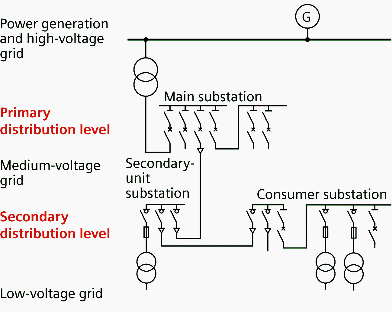

In analogy to distribution grids, switchgear can be assigned to the primary or secondary distribution level:
Primary Distribution – What is characteristic for the primary distribution level are high load and short-circuit currents and high-end secondary features of the switchgear with regard to protection, measuring, and (remote) control.
At the primary distribution level (Figure 1) you will find the main substation, where energy is fed in with a higher voltage and transformed to the medium-voltage level.
The switchgear is almost completely equipped with circuit-breakers. They switch large consumers, mostly in industrial plants, or cable rings which feed switchgear at the secondary distribution level.
Secondary Distribution – At the secondary distribution level, the switchgear is equipped with switches or a mixture of switches and circuit-breakers, where the proportion of switches
clearly dominates.
The currents are lower, short-circuit protection is often ensured by the assigned circuit breaker at the primary distribution level. The requirements placed on secondary features are usually lower.
Structure of the voltage and power distribution levels
Figure 1 – Structure of the voltage and power distribution levels

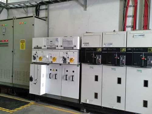

Generally speaking, typical forms of substation are:
Consumer substation
The consumer substation from which the energy is distributed at the fed-in line voltage (medium voltage).
A load transfer switch (coupling) in the substation can form the property border between the supply company and the customer if the customer wants to develop his switchgear part independently. In that case, measuring and metering equipment for billing will also be available.
Consumer substation
Figure 2 – Consumer substation
Secondary unit substation
The substation, also called secondary unit substation, where the energy is transformed from medium into low voltage and distributed as such.
In industrial plants, substations are often installed in the production centres which are also load centres. Therefore, these substations are called load-centre substations.

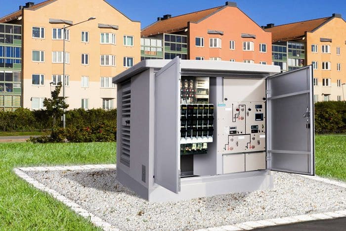

For very compact-built substations which are not accessible, the designation ‘small’ or ‘compact substation’ has become popular.
Compact substation
Figure 3 – Compact substation (on photo: New gas-insulated medium-voltage switchgear, 8DJH Compact, for secondary distribution systems up to 24 kV; credit: Siemens)

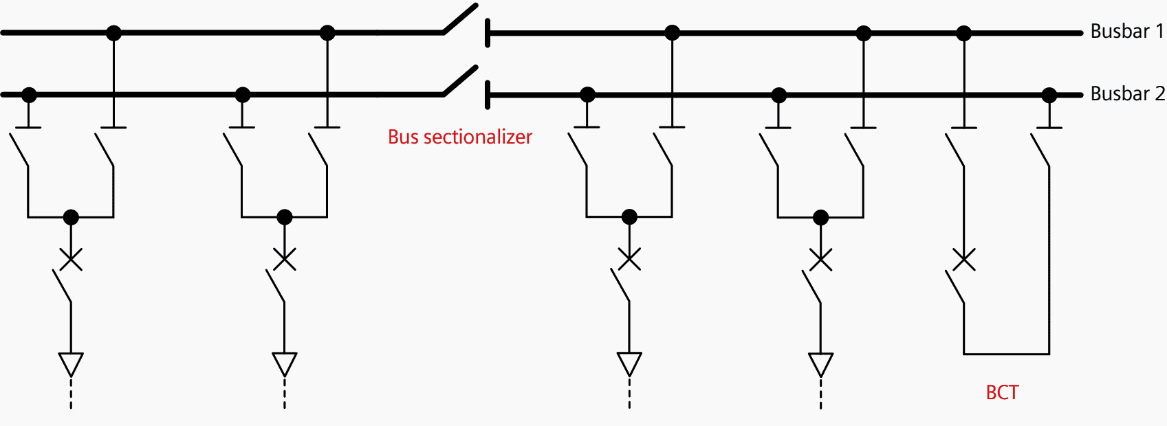

Busbar circuit
Selection parameter Determinants
  • Single / Double busbar
  • Bus sectionalizer/ busbar coupler, longitudinal (BCL)
  • Switch-over (BCL) using switch or circuit-breaker
  • Busbar coupler, transversal (BCT) (double busbar)
  • System confguration
  • Grid protection, response times, selectivity criteria
  • Reserves /service continuity, switch-over times
  • Operational procedures
  • Embedded or in-plant power generation, emergency power supply
  • Power quality (unsteady loads)
  • Double busbar with common connection
  • Two single busbar systems
  • Frequency of busbar switch-over
  • Interlockings, switching fault protection

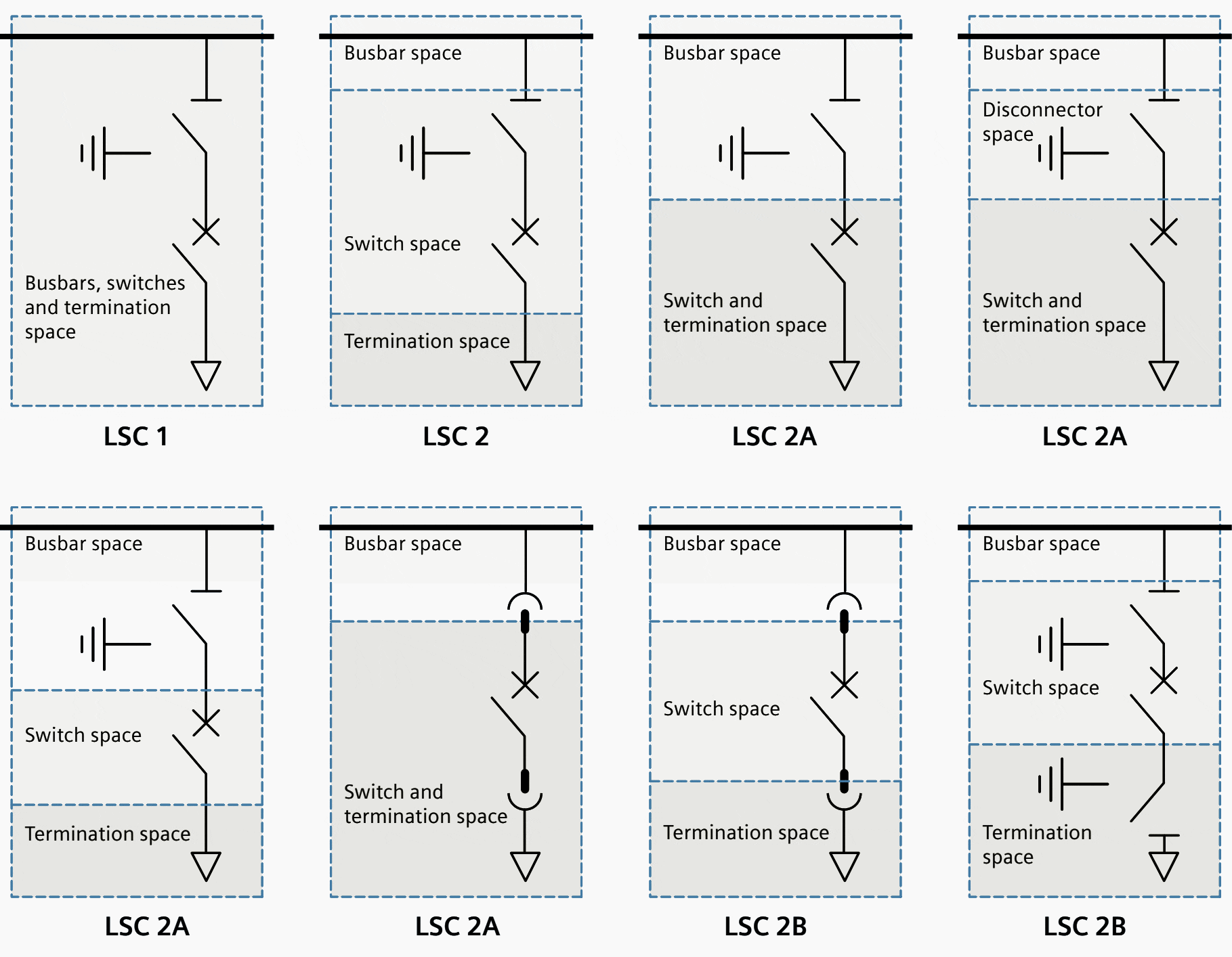

Compartments and partitions
  • Category of service continuity
    (compartment partitioning LSC – loss of service continuity)
    • LSC 1
    • LSC 2
    • LSC 2A
    • LSC 2B

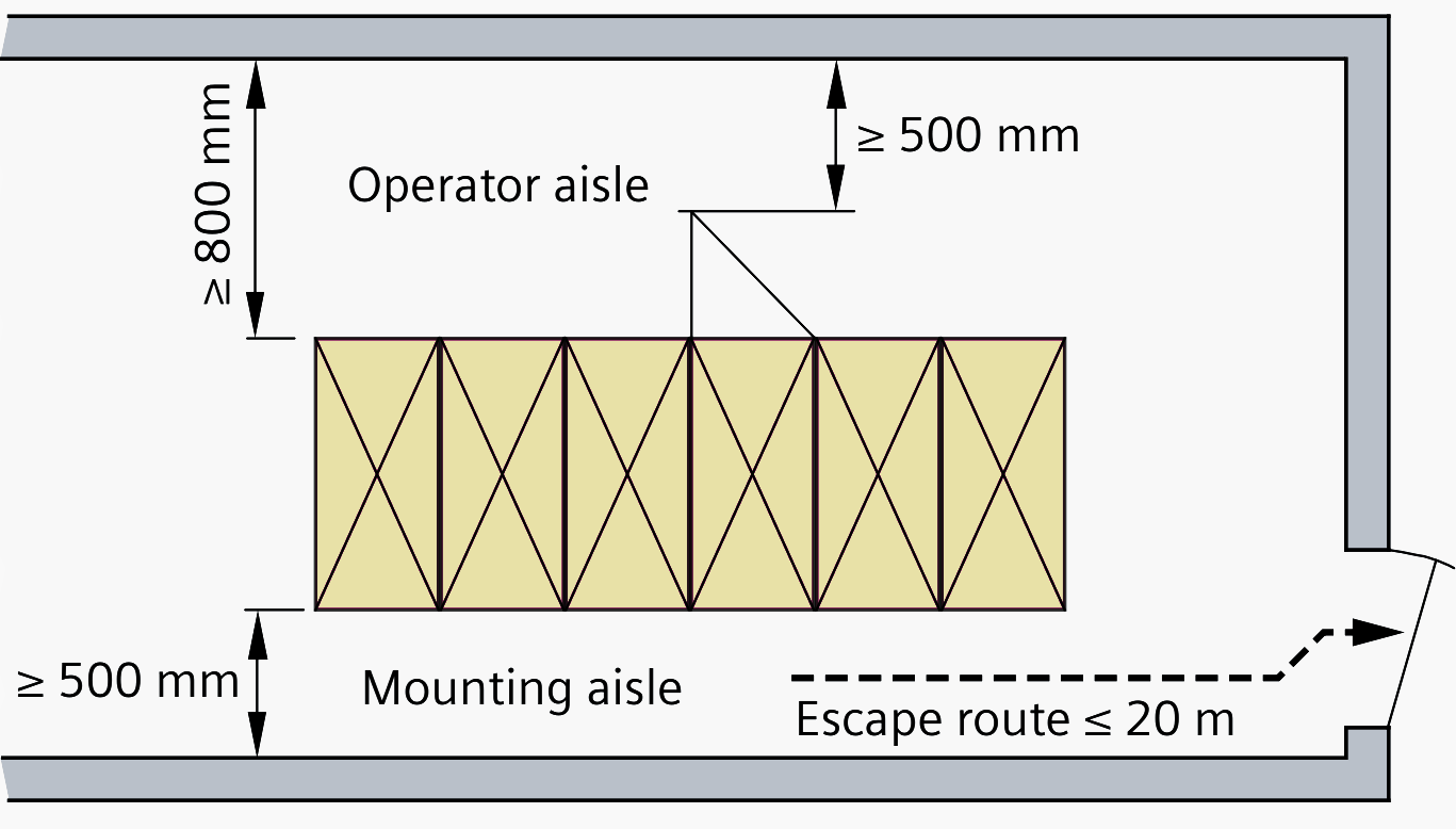

4.1. Operator protection
  1. The gas-insulated switchgear is safe to touch thanks to its earthed metal enclosure
  2. HV HRC fuses and cable terminations are only accessible if branch circuits are earthed
  3. Operation is only possible if the enclosure is fully sealed (and any doors closed)
  4. A maintenance-free pressure absorption system, laid out as “special cooling system” reduces pressure-related and thermal impacts of an arc fault so that personnel and building will be safe (Figure 4).
Room layout for switchgear with pressure relief downward (left) and with pressure absorption duct
Figure 4 – Room layout for switchgear with pressure relief downward (left) and with pressure absorption duct (click to expand)

4.3. Installation site
The medium voltage switchgear is usable as indoor installation in accordance with standard IEC 61936-1 (VDE 0101-1).
A distinction is made between:
  1. Switchgear types in locations with no access from the public, outside closed off electrical operating areas.
    Switchgear enclosures can only be removed with the aid of tools and operation by ordinary persons must be prevented.
  2. Closed electrical operating areas: A closed electrical operating area is a room or location used solely for the operation of electrical switchgear and is kept locked.
Access is only granted to electrically skilled persons and electrically instructed persons. Ordinary persons are allowed only when accompanied by electrically skilled or instructed persons.
Installation of switchgear in accordance with standard IEC 61936-1 (VDE 0101-1)

4.4. Operating and maintenance areas
  • These are corridors, connecting passages, access areas, transportation and escape routes.
  • Corridors and access ways must be sufficiently dimensioned for work, operation and transportation of components and must have a minimum width of 800 mm.
  • Corridor width must not be obstructed by equipment protruding into the corridor, such as permanently installed drives or switchgear trucks in disconnected position.
  • The width of the escape route must be at least 500 mm, even if removable parts or fully open doors protrude into the escape route.
  • Switchgear panel or cubicle doors should close in the direction of escape.
  • For mounting and maintenance work behind enclosed units (stand-alone) a passage width of 500 mm is sufficient.
  • A minimum height of 2,000 mm below ceilings, covers or enclosures, except for cable basements is required.
  • Exits must be arranged in such a way that the length of the escape route inside the room does not exceed 20 m in case of rated voltages up to 52 kV. This requirement does not apply to walk-in busbar or cable conduits or ducts.
  • For installations with a rated voltage up to 52 kV, the length of the escape route inside the room must not exceed 20 m (40 m for installations above 52 kV).
  • Fixed ladders or similar facilities are permissible as emergency exits in escape routes.

4.6. Service continuity during work in progress
IEC 62271-200 (VDE 0671-200) specifies categories of operational availability (LSC, loss of service continuity) of the functional units of a switchgear. They describe which parts must be put out of operation during the opening process of an accessible switchgear compartment.
Accessibility of switches and terminals is categorized according to Table 2 below:
Category of service continuity When an accessible compartment of the switchgear is opened… Type of construction
LSC 1 The busbar and therefore the complete switchgear must be isolated No partition plates within the panel, no panel partitions to the adjacent panels
LSC 2 LSC 2A Only the supply cable must be isolated. The busbar and the adjacent panels can remain in operation Panel partitions and isolating distance with compartmentalization to the busbar
LSC 2B The supply cable, the busbar, and the adjacent panels can remain in operation Panel partitions and isolating distance with compartmentalization to the busbar and the cable
Figure 6 (below) shows some examples for the different categories of service continuity:
Example for the service continuity (LSC) of medium voltage switchgear
Figure 6 – Example for the service continuity (LSC) of medium voltage switchgear

Double busbar
Reasons for using a double busbar can be, for example:
  1. Two or more feed-in points must always be operated separately (for example because there are different suppliers, or embedded power generation is used separate from the public grid).
  2. Consumers with disturbing perturbations on the grid are separated from consumers placing high requirements on the power supply quality.
  3. Consumers classified according to importance and assigned to service continuity requirements placed on the grids.
  4. Limited short-circuit strength of already installed equipment requires a subdivision into two subsystems with switch-overs for load balancing in case of varying power demand
Apart from the first example, examples two to four allow the use of a transversal busbar coupler (BCT), which permits changing busbars without interrupting the energy flow (Figure 7).
Duplicate busbar with bus sectionalizer and busbar coupler, transversal (BCT)
Figure 7a – Duplicate busbar with bus sectionalizer and busbar coupler, transversal (BCT)

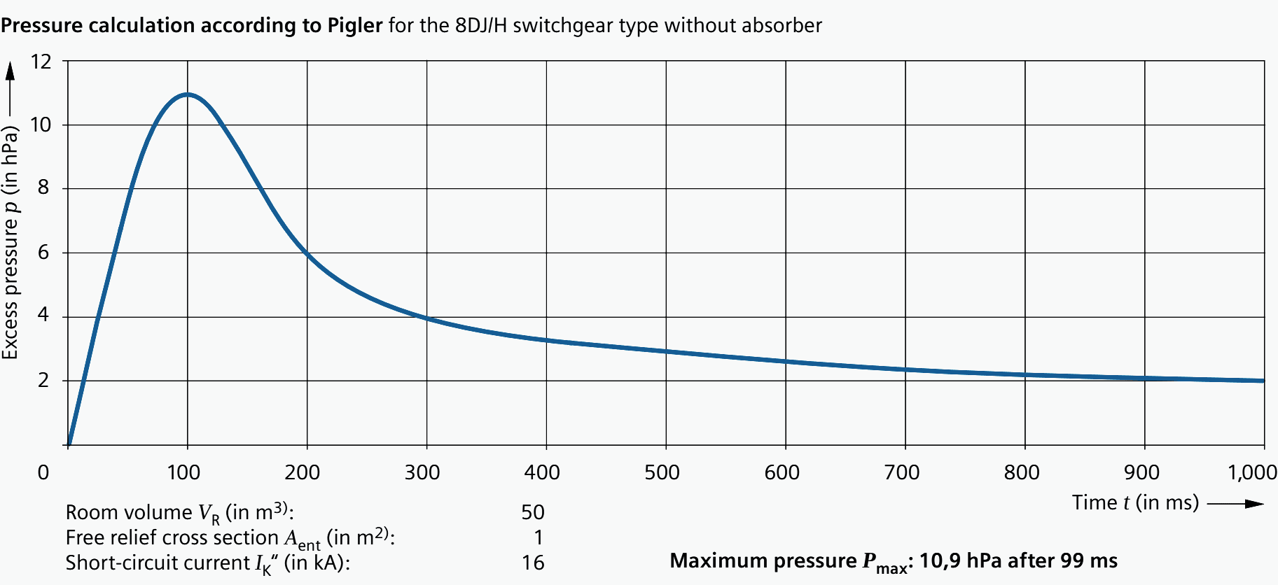

4.9. Estimation of pressure effects according to Pigler
A simple method provides the estimation according to F. Pigler for rooms up to 50 m³. Data on the room volume, the area of the free relief cross section and the short-circuit current to be tested are entered into a matrix.
This supplies a simple curve progression for the overload pressure (see Figure 8).
Example of stationary excess pressures resulting from internal arcing faults
Figure 8 – Example of stationary excess pressures resulting from internal arcing faults

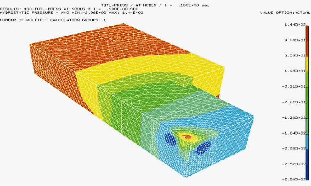

4.10. Finite-elements-simulation of pressure load under conditions of arcing
Although the incidence of an internal fault (arc fault) is very unlikely in type-tested air- or gas-insulated switchgear, the consequences of such an arcing fault may be severe for the operating personnel as much as for the room itself.
For this reason, appropriate measures in relation to the room situation must be provided for pressure relief, such as pressure relief outlets, ducts, absorbers or coolers. Possibly this must already be considered during the installation and room planning stage.
With the aid of ultra-modern finite element methods, pressure calculations can be performed in the entire three-dimensionally mapped space over the entire burning time of the accidental arc.
Some manufacturers of MV switchgears, such as Siemens – offers the service of a numerical calculation on the basis of a 3D volume model, where the real installation of the switchgear, pressure development, reflection, and arrangement of the pressure relief openings is taken account of.
Contour plotting of a simulation at the point 0.1 s
Figure 9 – Contour plotting of a simulation at the point 0.1 s
Various pressure load scenarios can be calculated for specific switchgear types, short-circuit currents, and installation sites. Thus the customer benefits from extended planning security and a cost-optimised solution.
The flow conditions are defined as boundary conditions. Firstly, these are the switchgear steel sheets and secondly, the absorber sheets to be penetrated. At last, the pressure relief openings in the switchgear room are defined. But the model also allows to calculate a fully enclosed room, or factor in pressure relief openings with a pre-defined response pressure. As a result, the model yields the pressure rise and the flow conditions at any point of the finite elements grid over time.
Additionally, the pressure distribution on the walls can be shown as a contour plotting at a certain point in time (Figure 9).
Note: Typically, the overpressure caused by an arcing fault, when assuming the same room volume, is significantly higher for air-insulated switchgear than for metal-enclosed, gas-insulated switchgear.
