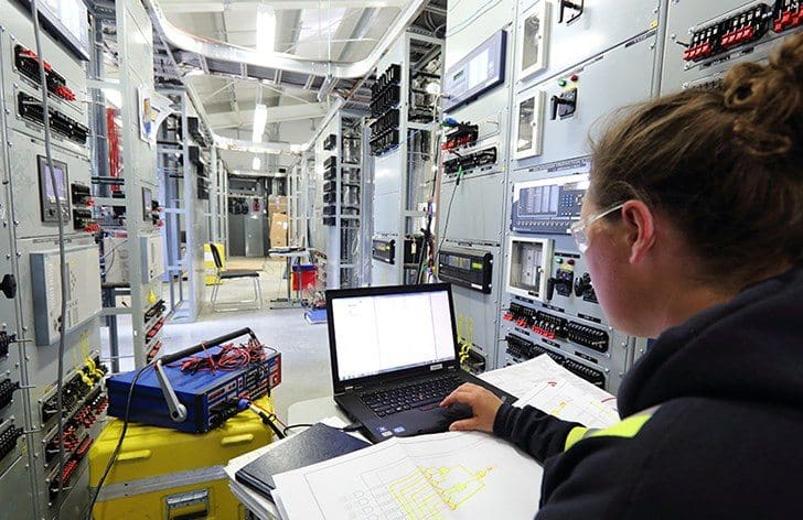

Insulation resistance tests performed on protection relays
Insulation resistance tests performed on protection relays (photo credit: canahighvoltage.ca)

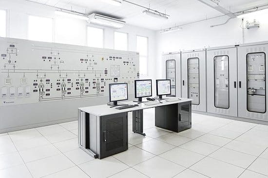

Substation control system - HMI computers
Substation control system – HMI computers (photo credit: processautomationinsights.com)

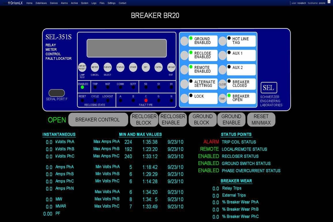

Alarm annunciator that displays real-time alarms that can be sorted, filtered, individually disabled or enabled, and silenced based upon multiple criteria such as alarm name, group, and time.
HMI of SEL protection relay
HMI of SEL protection relay (photo credit: novatechweb.com)

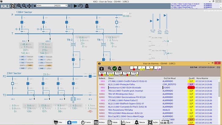

OSHMI – Open Substation HMI
OSHMI – Open Substation HMI (photo credit: modosimul.wordpress.com)

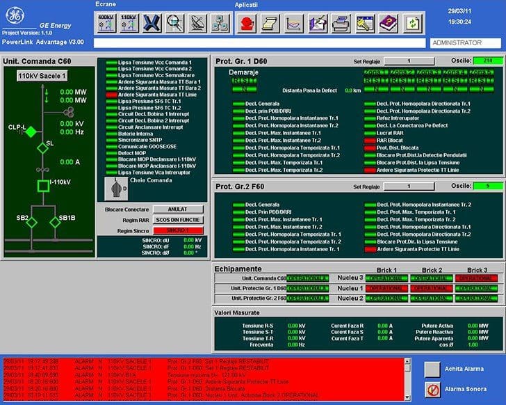

HMI screen of OHL 110 kV details page
HMI screen of OHL 110 kV details page (photo credit: dacom.ro)
