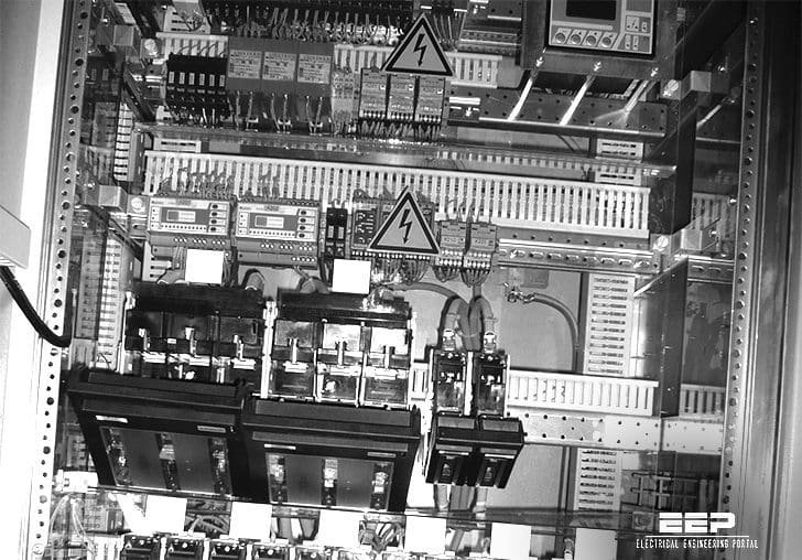

DC power supply in substation
DC power supply in substation (photo credit: btechinc.com)
