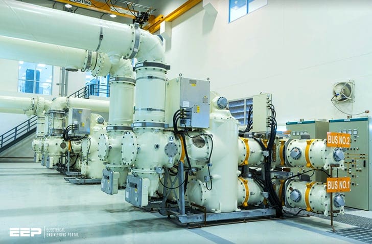

Fully digital substation
Developments in communication have done much to realize the digital substation, but to realize a full digital substation it is necessary to have everything in digital form. Whilst much substation protection, control, and automation technology has always been digital (trip signals, interlocking signals, etc.), the principal power system inputs of voltage and current have traditionally been presented in analogue form.
Current and voltage digital transformation in a modern substation protection and automation
It has been traditional to present scaled versions of power system currents and voltages to measuring devices, protective relays etc. Scaled versions can easily be produced using conventional electrical transformers, although capacitor dividers may be additionally employed for transforming very high voltages.

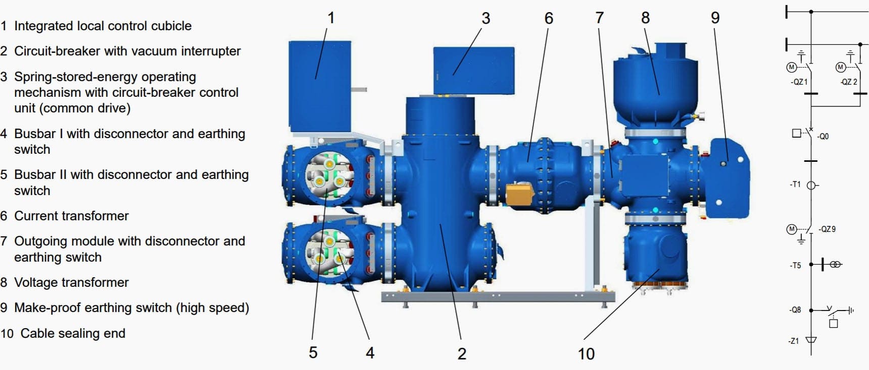

Conventional transformers based on iron cores introduce measurement errors. Due to the wide dynamic range of current signals on power systems, current transformers for protection need large cores to avoid saturation under fault conditions.
Due to the nature of the magnetic core material, however, these large cores produce significant errors at nominal current, which renders them impractical for metering purposes.
Therefore metering-class transformers need to be introduced resulting in increasing costs.
The iron core is a source of inaccuracy due to the need to magentize the core, as well as the effect of flux remanence, flux leakage, eddy current heating, etc.
Conventional wired 1A/5A current transformers (CT) circuits have thermal overload constraints, and pose increasing burdens on the core as cross-site wire run lengths increase.
This can degrade protection performance, potentially leading to the need to duplicate CTs. Conventional voltage transformer (VT) circuits may experience ferro-resonance phenomena, with thermal overstress resulting. Capacitor voltage transformers (CVT) can produce high frequency interference signals.
GIS up to 145 kV Switchgear bay (with conventional Instrument Transformer)
Figure 1 – Siemens GIS up to 145 kV Switchgear bay (with conventional Instrument Transformer)

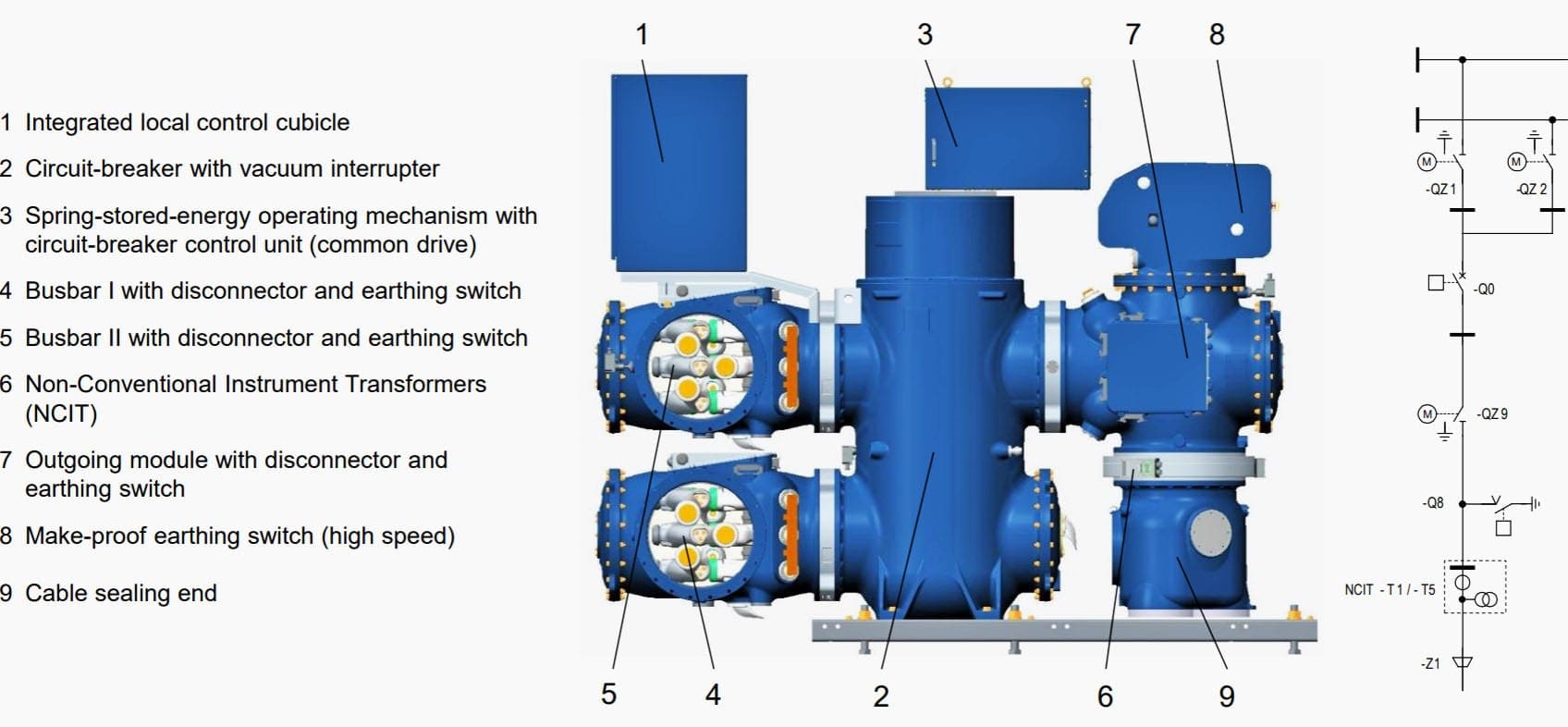

GIS up to 145 kV Switchgear bay (with Non-conventional Instrument Transformer)
Figure 2 – Siemens GIS up to 145 kV Switchgear bay (with Non-conventional Instrument Transformer)
NCIT technologies may be based on optical techniques, or Rogowski coils, and overcome the limitation of iron-cored transformers by delivering:
  1. Single devices providing measurement class accuracy with dynamic ranges also capable of faithfully reproducing fault currents.
  2. Reliable, repeatable accuracy.
  3. High measurement bandwidth for rated frequency, harmonics, and sub-harmonics.
  4. Low electrical stress insulation – no premature ageing, moisture ingress, or risk of explosion.
As well as having a lower risk of explosion, NCIT devices are also inherently safer since they cannot be ‘open-circuited’.

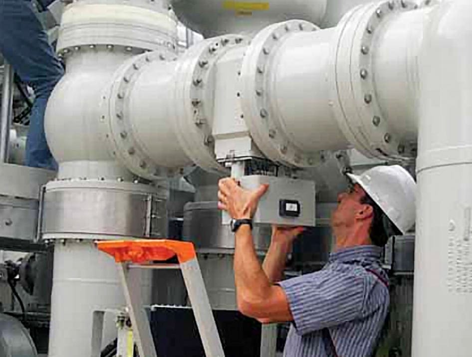

An NCIT device based on Rogowski coil technology is shown in Figure 3 below.
Rogowski coil installation in GIS (gas insulated switchgear)
Figure 3 – Rogowski coil installation in GIS (gas insulated switchgear)

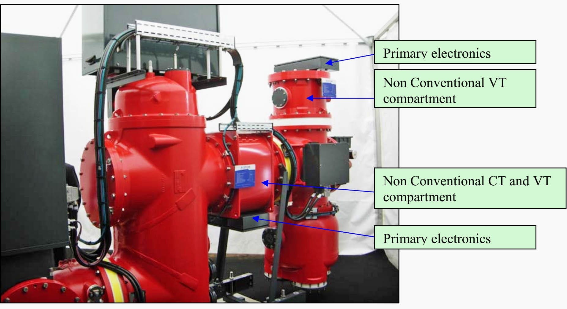

View of a very compact three-phased GIS with NCIT
Figure 4 – View of a very compact three-phased GIS with NCIT
The current trends address a large number of different technologies and applications of the sensors like, for instance, Rogowski or optical-type current transformers, electronic or magnetic-type core for metering, capacitive effect voltage transformers of different technologies, together with demanding high specification in term of:
“Reliability, Availability and Maintenance” performance criteria.

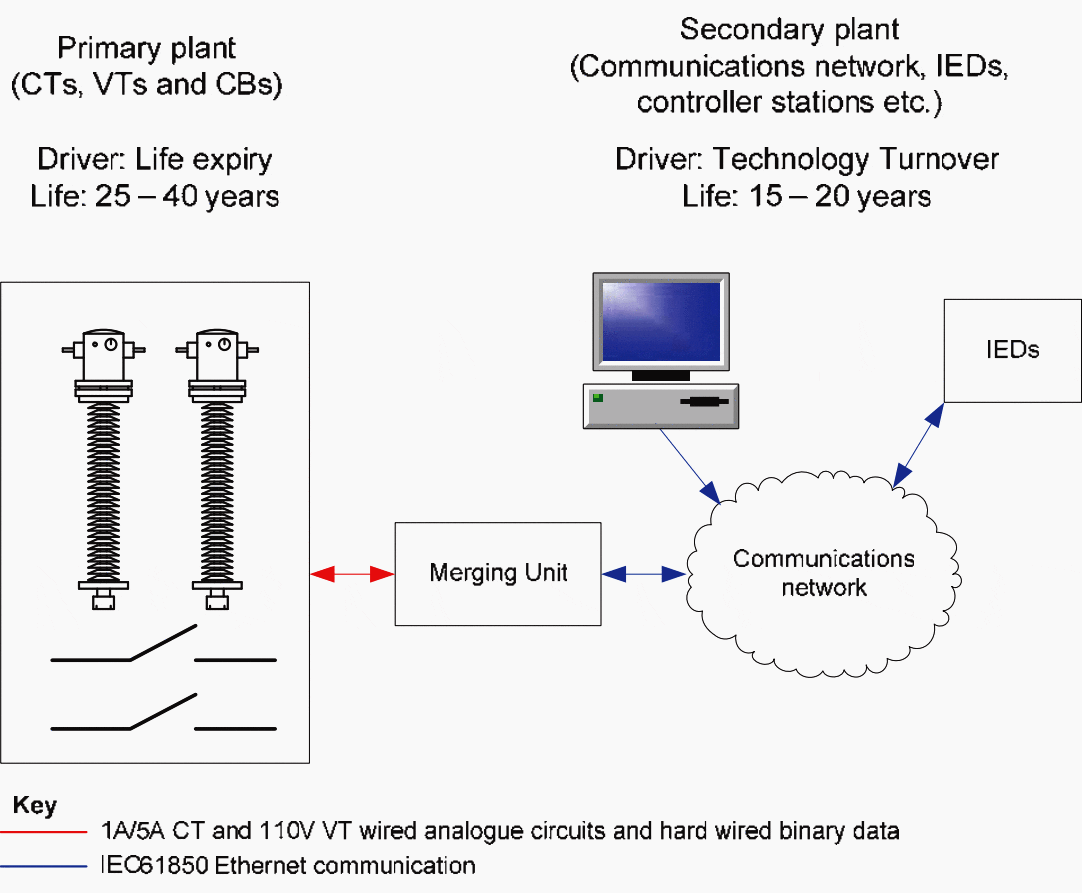

As well as connecting with NCIT technology such as optical sensors and Rogowski coils, merging units can also be provided in conjunction with conventional transformer technology such that numerical equivalents of system current and voltage can be provided over communication buses.
Using merging units with conventional current and voltage transformers allows the different life-cycle expectations of primary and secondary plant to de de-coupled as per Figure 5.
De-coupling primary and secondary plant with merging units
Figure 5 – De-coupling primary and secondary plant with merging units

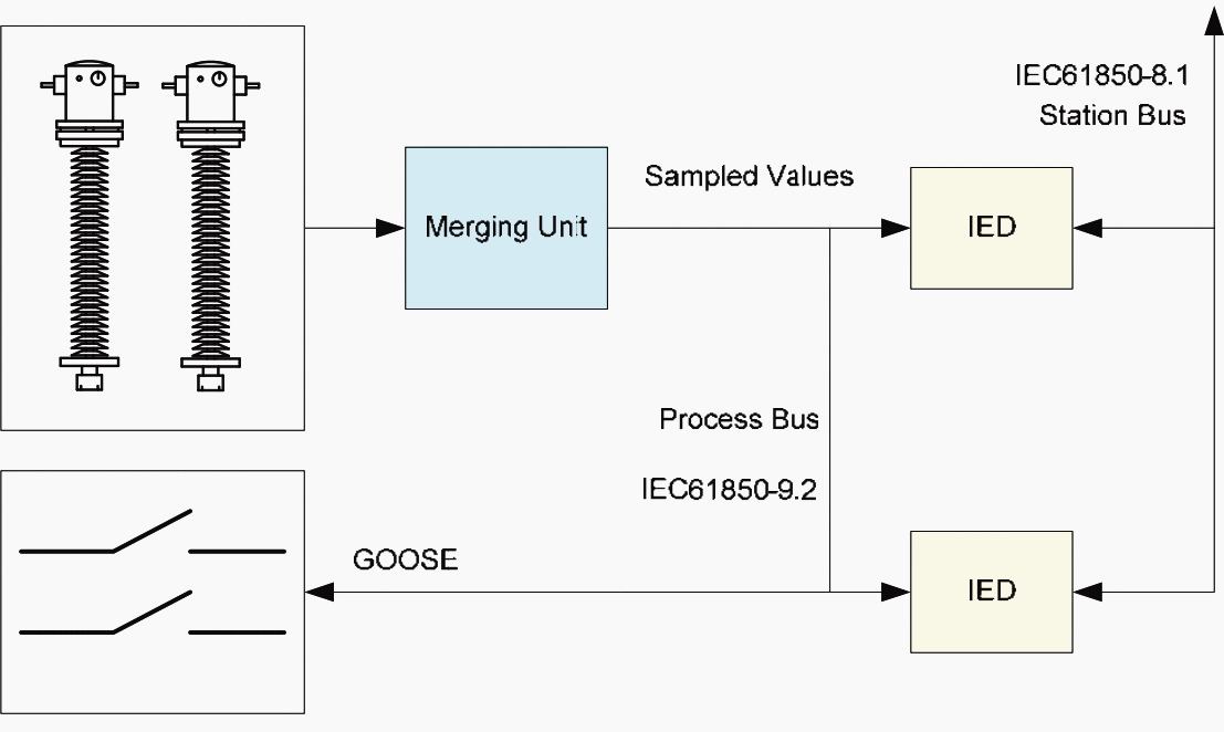

The connections to the process bus and station bus are in accordance with the IEC61850 standard that is introduced later in this chapter and is shown in Figure 6.
Location of merging unit (MU) in the substation
Figure 6 – Location of merging unit (MU) in the substation
Each merging unit module offers signal processing to provide sampled values of phase currents (Ia, Ib, Ic), phase voltages (Va, Vb, Vc), plus residual current and residual voltage. The sampled value frames are multicast via Ethernet, using a fibre optic, or copper Ethernet connection. The outputs of the merging units need to be accurately time stamped.
This requires the merging units to be accurately time-synchronised, and this is discussed in the next section.

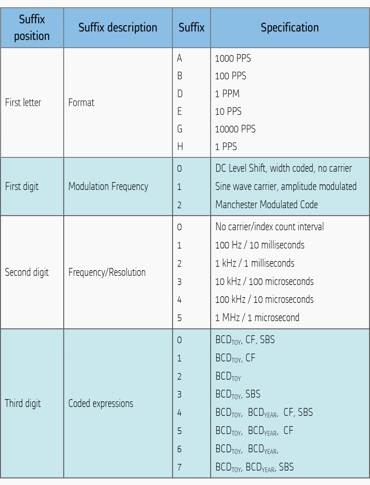

In 1956 the American Inter Range Instrumentation Group standardized the different time code formats. These were published in the IRIG Document 104-60. This was revised in 1970 to IRIG Document 104-70, and published later as IRIG Standard 200-70.
The name of an IRIG code format consists of a single letter plus 3 subsequent digits. Each letter or digit reflects an attribute of the corresponding IRIG code.

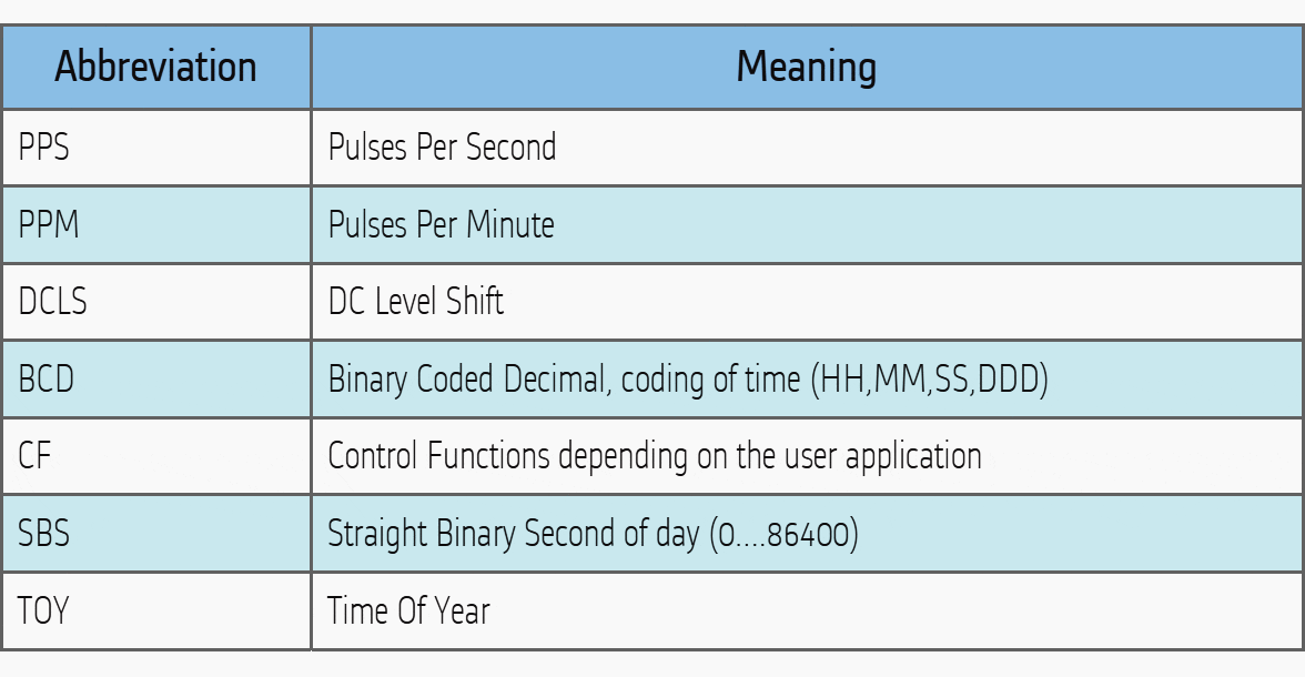

The following tables contain the meanings of the suffixes and descriptions of the abbreviations used.
Table 1 – Serial time code formats
Table 2 – Suffix Descriptions
Suffix Descriptions
There are many subsets of the IRIG-B format. IRIG-B is the standard for time synchronization using 100 PPS. It was this flavour that was embraced by the utility industry to provide real-time information exchange between substations.
For IED time synchronisation, IRIG-B12x is typically used for modulated signals and IRIG-B00x for demodulated signals.

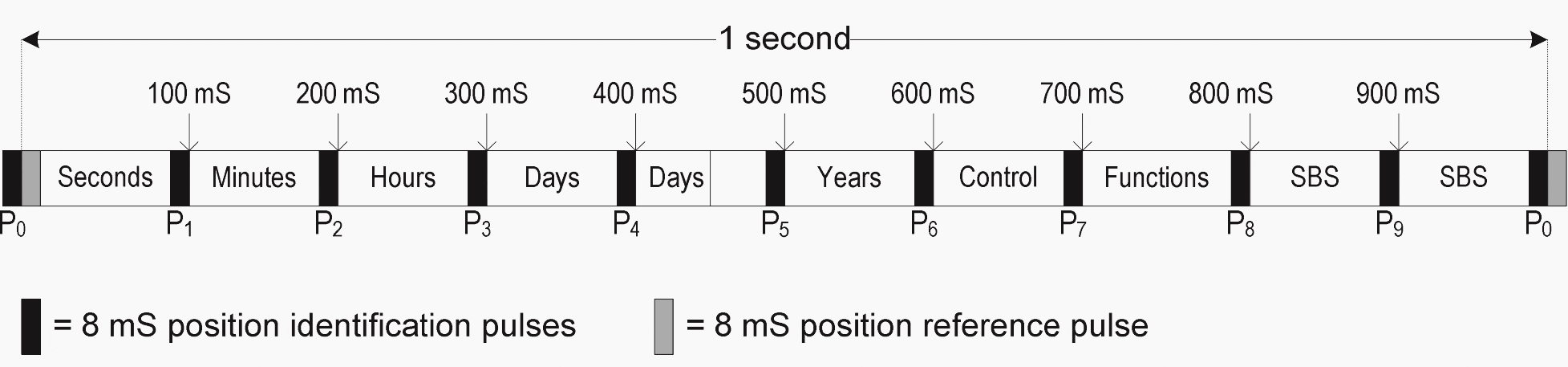

The IRIG-B time code signal is a sequence of one second time frames. Each frame is split up into ten 100ms slots as follows:
  • Time-slot 1: Seconds
  • Time-slot 2: Minutes
  • Time-slot 3: Hours
  • Time-slot 4: Days
  • Time-slot 5 and 6: Control functions
  • Time-slots 7 to 10: Straight binary time of day
The first four time-slots define the time in binary-coded decimal (BCD). Time-slots 5 and 6 are used for control functions, which control deletion commands and allow different data groupings within the synchronization strings. Time-slots 7-10 define the time in SBS (Straight Binary Second of day).
Each frame starts with a position reference and a position identifier. Each time-slot is further separated by an 8mS position identifier.
A typical 1 second time frame is illustrated in Figure 7. If the control function or SBS time-slots are not used, the bits defined within those fields are set as a string of zeroes.
IRIG-B frame construction
Figure 7 – IRIG-B frame construction
The 74-bit time code contains 30 bits of BCD time-of-year information in days, hours, minutes and seconds, 17 bits of SBS, 9 bits for year information and 18 bits for control functions.
The BCD code (seconds sub-word) begins at index count 1 with binary coded bits occurring between position identifier bits P0 and P6: 7 for seconds, 7 for minutes, 6 for hours, 10 for days and 9 for year information between position identifiers P5 and P6 to complete the BCD word.
An index marker occurs between the decimal digits in each sub-word to provide separation for visual resolution.
The SBS word begins at index count 80 and is between position identifiers P8 and P0 with a position identifier bit, P9 between the 9th and 10th SBS coded bits. The SBS time code recycles each 24-hour period. The eighteen control bits occur between position identifiers P6 and P8 with a position identifier every 10 bits.
The frame rate is 1.0 second with resolutions of 10ms (dc level shift) and 1ms (modulated 1 kHz carrier).
