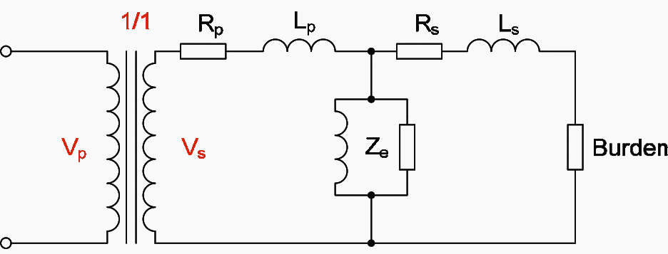

1. Simple equivalent circuit of current transformer
The transformer can be represented by the equivalent circuit of Figure 1, where all quantities are referred to the secondary side.
Equivalent circuit of transformer
Figure 1 – Equivalent circuit of transformer
When the transformer is not 1/1 ratio, this condition can be represented by energizing the equivalent circuit with an ideal transformer of the given ratio but having no losses.
Voltage and current transformers for low primary voltage or current ratings are not readily distinguishable. For higher ratings, dissimilarities of construction are usual. Nevertheless the main differences between these devices are the way they are connected into the power circuit.
Voltage transformers are much like small power transformers, differing only in details of design that control ratio accuracy over the specified range of output. Current transformers have their primary windings connected in series with the power circuit, and so also in series with the system impedance.
The response of the transformer is radically different in these two modes of operation.

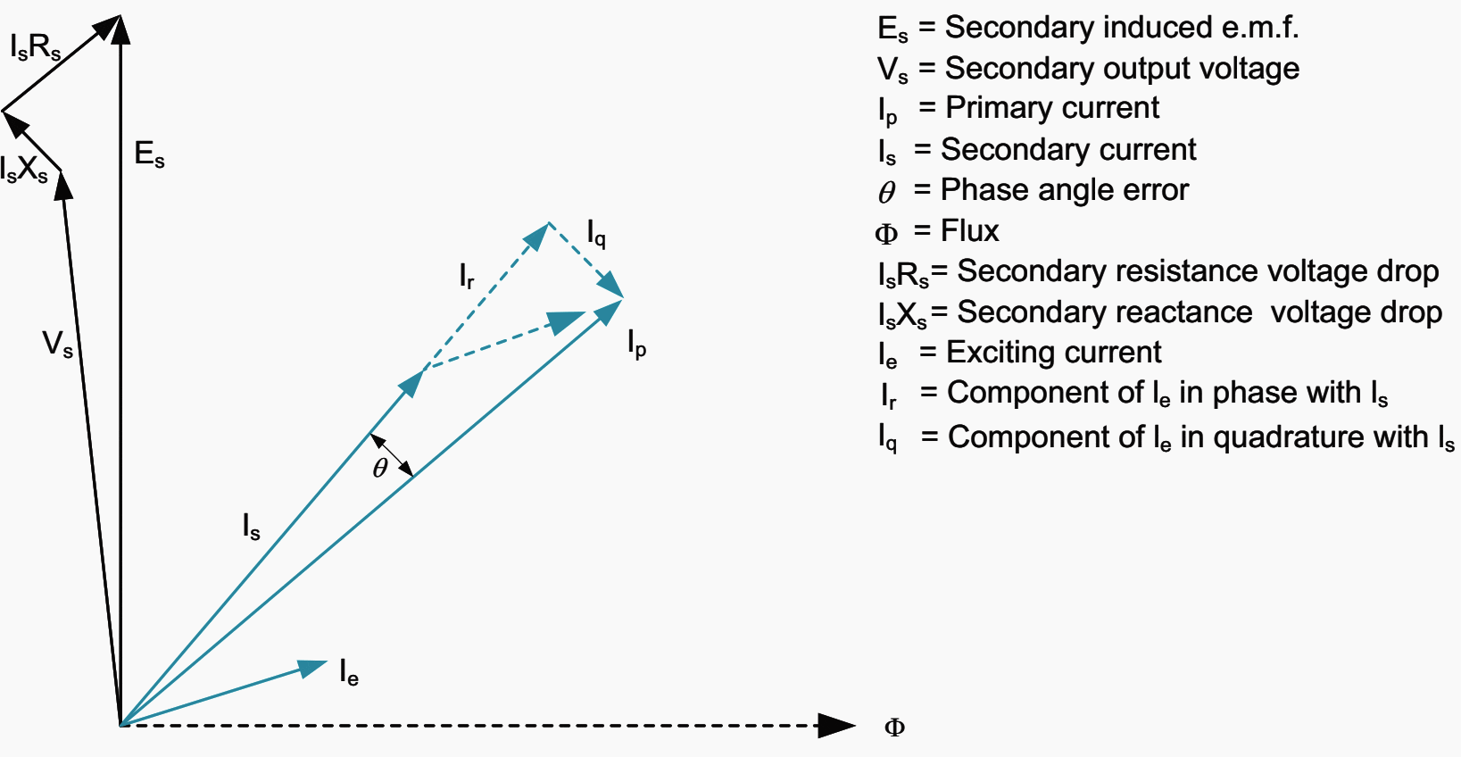

2.1 Errors
The general vector diagram applicable for voltage transformer (click to see it) can be simplified by omitting details that are not of interest in current measurement. Take a look at the Figure 3.
Errors arise because of the shunting of the burden by the exciting impedance. This uses a small portion of the input current for exciting the core, reducing the amount passed to the burden.
So, Is = Ip − Ie
where Ie is dependent on Ze, the exciting impedance and the secondary e.m.f. Es, given by the equation:
E= I(Z+ Zb),
where:
  • Zs = the self-impedance of the secondary winding, which can generally be taken as the resistive component Rs only
  • Zb = the impedance of the burden
Vector diagram for current transformer (referred to secondary)
Figure 3 – Vector diagram for current transformer (referred to secondary)
2.1.1 Current or Ratio Error
This is the difference in magnitude between Ip and Is and is equal to Ir, the component of Ie which is in phase with Is.
2.1.2 Phase Error
This is represented by Iq, the component of Ie in quadrature with Is and results in the phase error Φ .
The values of the current error and phase error depend on the phase displacement between Is and Ie, but neither current nor phase error can exceed the vectorial error Ie. With a moderately inductive burden, resulting in Is and Ie approximately in phase, there is little phase error and the exciting component results almost entirely in ratio error.
A reduction of the secondary winding by one or two turns is often used to compensate for this.
For example, in the CT corresponding to Figure 2, the worst error due to the use of an inductive burden of rated value would be about 1.2%. If the nominal turns ratio is 2:120, removal of one secondary turn would raise the output by 0.83% leaving the overall current error as -0.37%.
For lower value burden or a different burden power factor, the error would change in the positive direction to a maximum of +0.7% at zero burden; the leakage reactance of the secondary winding is assumed to be negligible.
No corresponding correction can be made for phase error, but it should be noted that the phase error is small for moderately reactive burdens.

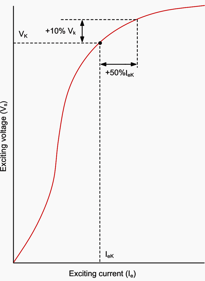

2.4 Class PX Current Transformers
The classification of Table 3 is only used for overcurrent protection. Class PX is the definition in IEC 61869 for the quasi-transient current transformers formerly covered by Class X of BS 7626, commonly used with unit protection schemes.
Guidance was given in the specifications to the application of current transformers to earth fault protection, but for this and for the majority of other protection applications it is better to refer directly to the maximum useful e.m.f. that can be obtained from the CT.
In this context, the ‘knee-point’ of the excitation curve is defined as ‘that point at which a further increase of 10% of secondary e.m.f. would require an increment of exciting current of 50%’.
See Figure 4 below.
Definition of knee-point of excitation curve
Figure 4 – Definition of knee-point of excitation curve
Design requirements for current transformers for general protection purposes are frequently laid out in terms of  knee-point e.m.f., exciting current at the knee-point (or some other specified point) and secondary winding resistance.
Such current transformers are designated Class PX.

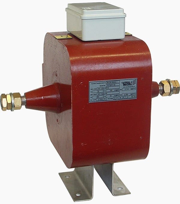

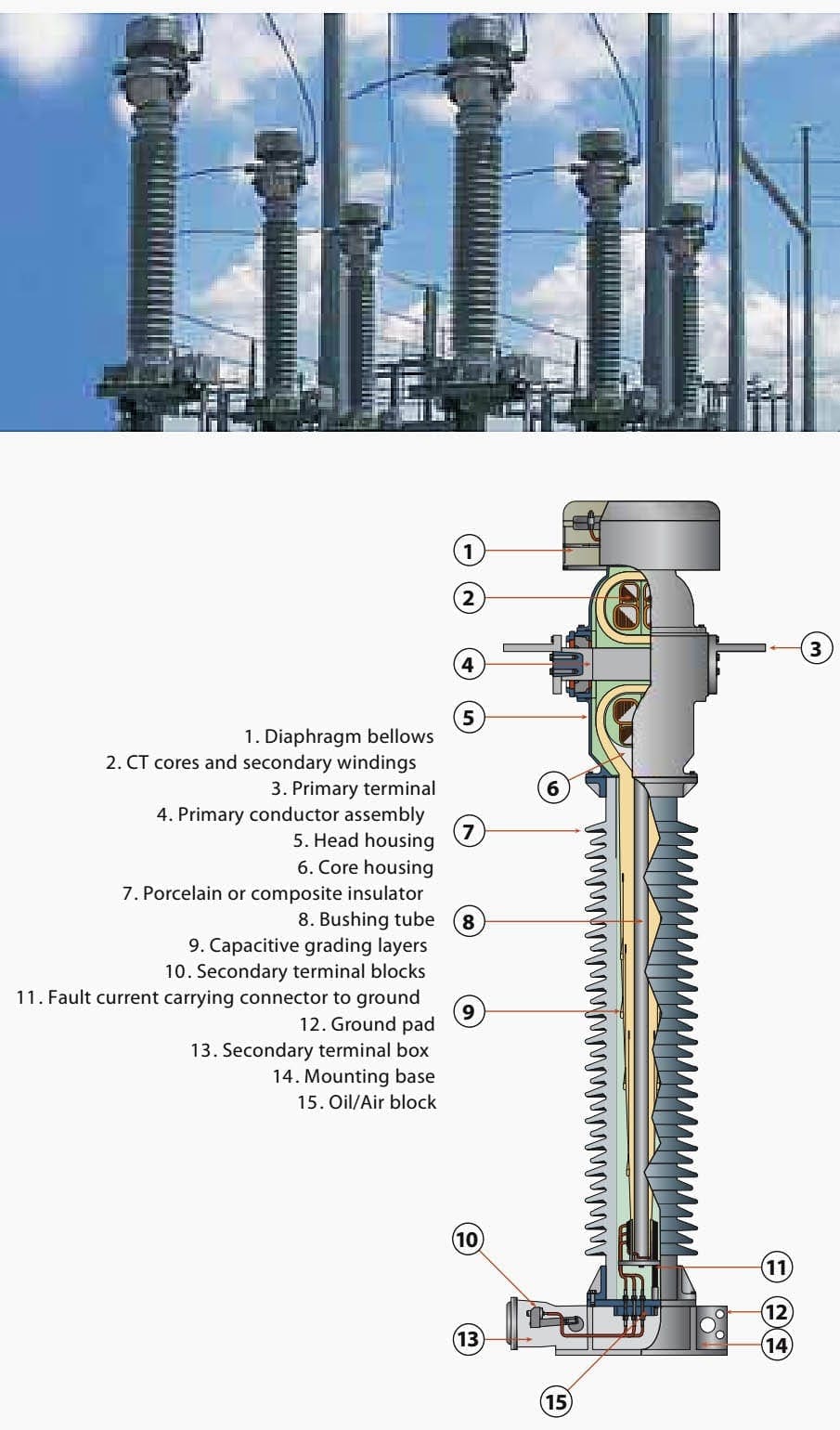

2.5.2 Bushing or bar primary type
Many current transformers have a ring-shaped core, sometimes built up from annular stampings, but often consisting of a single length of strip tightly wound to form a close-turned spiral. The distributed secondary winding forms a toroid which should occupy the whole perimeter of the core, a small gap being left between start and finish leads for insulation.
Such current transformers normally have a single concentrically placed primary conductor, sometimes permanently built into the CT and provided with the necessary primary insulation.
In other cases, the bushing of a circuit breaker or power transformer is used for this purpose.
At low primary current ratings it may be difficult to obtain sufficient output at the desired accuracy. This is because a large core section is needed to provide enough flux to induce the secondary e.m.f. in the small number of turns, and because the exciting ampere-turns form a large proportion of the primary ampere-turns available.
The effect is particularly pronounced when the core diameter has been made large to fit over large EHV bushings.
Bar Primary Type Current Transformer
Figure 6 – Bar Primary Type Current Transformer (CT having Single Primary turn with the Primary Conductor embedded)

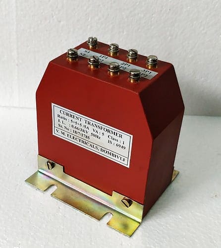

2.5.4 Summation Current Transformers
The summation arrangement is a winding arrangement used in a measuring relay or on an auxiliary current transformer to give a single-phase output signal having a specific relationship to the three-phase current input.
Summation current transformer is used when the currents in a number of feeders don’t need to be individually metered but summated to a single meter or instrument. The summation CT consists of two or more primary windings which are connected to the feeders to be summated, and a single secondary winding, which feeds a current proportional to the summated primary current.
A typical ratio would be 5+5+5/ 5A, which means that three primary feeders of 5 are to be summated to a single 5A meter.
Figure 8 – Summation Current Transformer

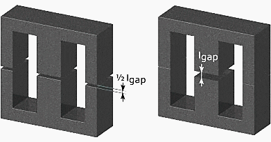

2.5.5 Air-gapped current transformers
These are auxiliary current transformers in which a small air gap is included in the core to produce a secondary voltage output proportional in magnitude to current in the primary winding.
Sometimes termed ‘transactors’ and ‘quadrature current transformers’, this form of current transformer has been used as an auxiliary component of traditional pilot-wire unit protection schemes in which the outputs into multiple secondary circuits must remain linear for and proportional to the widest practical range of input currents.
Figure 9 – Air-gapped current transformer

Figure 10 shows a CT for use on HV systems.
Alstom OSKF 72.5kV to 765kV high voltage current transformer
Figure 10 – Alstom OSKF 72.5kV to 765kV high voltage current transformer

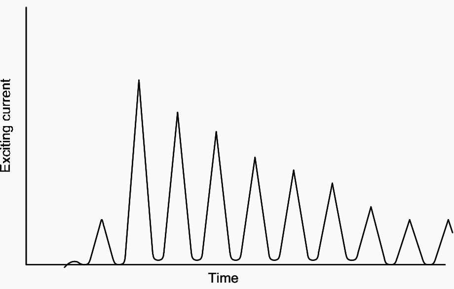

The asymmetric (or d.c.) component can be regarded as building up the mean flux over a period corresponding to several cycles of the sinusoidal component, during which period the latter component produces a flux swing about the varying ‘mean level’ established by the former. The asymmetric flux ceases to increase when the
exciting current is equal to the total asymmetric input current, since beyond this point the output current, and hence the voltage drop across the burden resistance, is negative.
Saturation makes the point of equality between the excitation current and the input occur at a flux level lower than would be expected from linear theory.
When the exponential component drives the CT into saturation, the magnetizing inductance decreases, causing a large increase in the alternating component ie.
The total exciting current during the transient period is of the form shown in Figure 13 and the corresponding resultant distortion in the secondary current output, due to saturation, is shown in Figure 14.
Typical exciting current of CT during transient asymmetric input current
Figure 13 – Typical exciting current of CT during transient asymmetric input current
