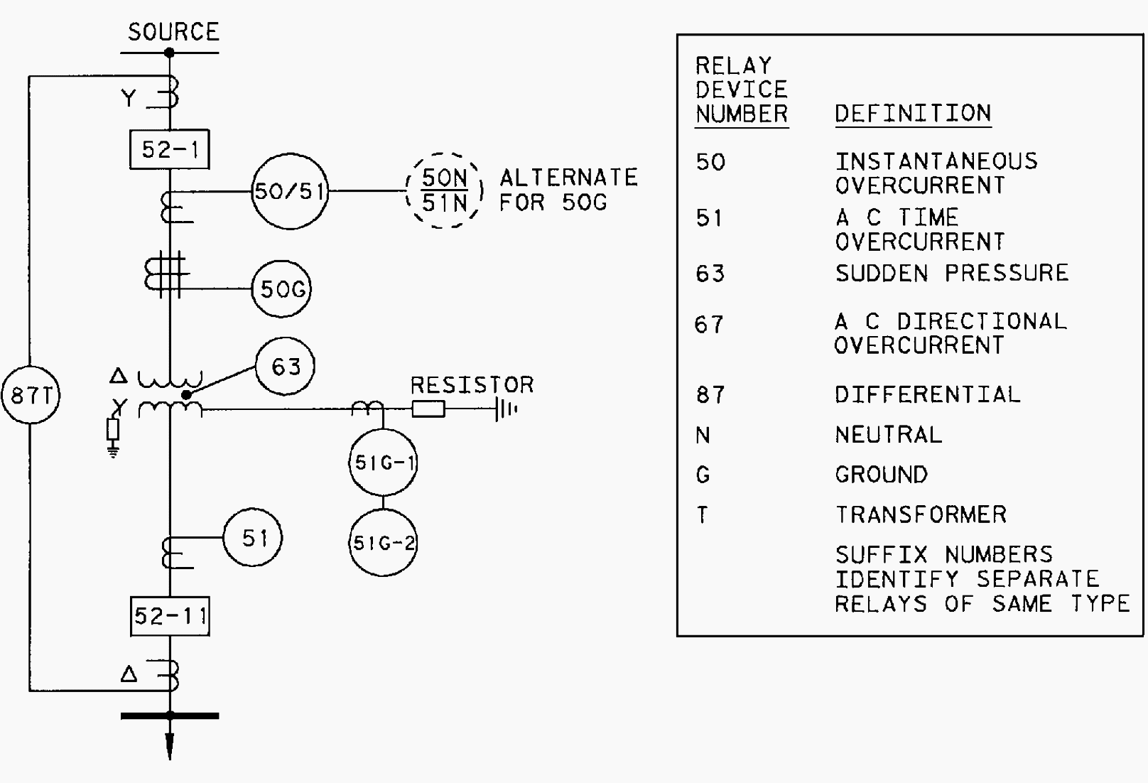

Figure 1 shows how a primary breaker can be used for transformer protection.
Transformer protection with primary breaker (no load or metering circuits shown)
Figure 1 – Transformer protection with primary breaker (no load or metering circuits shown)
The basic protection is provided by the 87T transformer differential relays. Device 50/51, overcurrent relay with instantaneous unit, provides primary protection for phase faults; either Device 50G or 50N/51N can be used as backup protection for ground faults.
Transformer overload, low-voltage bus, and feeder backup protection is provided by Device 51 on the secondary side.
Since the low-voltage side is resistance-grounded, a ground relay (51G-1) should be used to trip Breaker 52-1 for low-side ground faults between the transformer and the secondary breaker and for resistor thermal protection.
Device 51G-2, which trips Breaker 52-11, provides bus ground- fault protection and feeder ground backup, while Device 63 offers highly sensitive detection of low-magnitude transformer faults.
Devices 50/51, 51, 51G-1, 50G, and 51G-2 require coordination to provide zones of protection, which will aid in fault location.

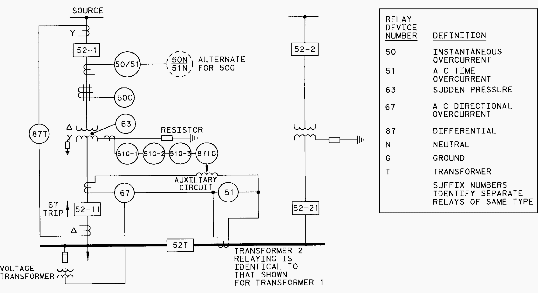

When a normally closed secondary bus tie is used for paralleled transformer protection (figure 2 above), there are several differences from the primary breaker scheme shown in Figure 1.
First, Device 87TG provides selective and sensitive protection for ground faults within the secondary circuit of the differential zone. In addition to Devices 51G-1 and 51G-2 shown in figure 1, a 51G-3 relay is used to trip Breaker 52T on ground faults.
The trip sequence of these three ground relays is as follows:
  1. 51G-3 Trips 52T,
  2. 51G-2 Trips 52-11,
  3. 51G-1 Trips 52-1, and
  4. 87TG Trips 52-1 and 52-11.
Device 67 provides directional overcurrent protection.

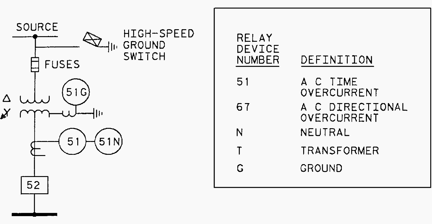

If the transformer size does not warrant the basic schemes described above, the schemes shown in figures 3 and 4 may be used. Here, fuses provide the primary fault protection. Solid grounding will assure sufficient primary phase fault current to operate the fuses for most secondary ground faults.
In cases where secondary ground faults do not produce enough fault current to blow primary fuses, a 51G relay may be used to trip a high-speed ground switch, as shown in Figure 3.
Transformer protection with primary fuses (no load or metering circuits shown)
Figure 3 – Transformer protection with primary fuses (no load or metering circuits shown)
The opening of a single primary fuse will result in single phasing of the transformer secondary system. This may be difficult to detect, particularly at light loads, and appropriate precautionary measures should be taken. If the utility source is grounded and there is a power source on the secondary side, a ground fault on the incoming line will be interrupted by the utility breaker.
The secondary breaker, however, will not be relayed open because no ground-fault current will flow through the delta primary transformer connection.
Failure of the secondary breaker to open can result in hazards to personnel, possible damaging transient overvoltages produced by an arcing-type fault, and prevention of automatic reclosing of the utility breakers.
Several schemes can be used to ensure opening of the secondary breaker, including pilot protection of the incoming line, transfer-trip, reverse-power relaying, or potential ground-detection-relaying schemes on the transformer primary. The utility will prevent automatic reclosing of its breaker if the plant’s secondary breaker is not open.
Note that certain fusible switches are available that will automatically open all three phases should a fuse melt on single-phase.

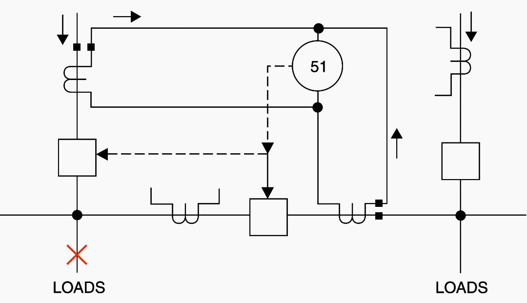

When applied for bus protection, the partial differential scheme is most commonly used for protection of plant main buses. In this scheme, only the source circuits are differentially connected, using an overcurrent relay with time delay. The relays protecting the feeders or circuits are not in the differential.
Essentially, this arrangement combines time-delay bus protection with feeder backup protection.
Partial differential relaying (three-breaker scheme)
Figure 5 – Partial differential relaying (three-breaker scheme)
