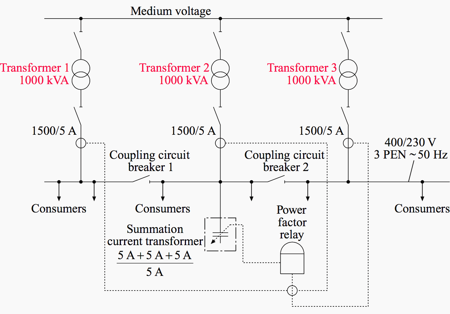

1. Measuring by Means of Summation Current Transformer
Larger electrical plants have multiple feed-ins with two or more power transformers usually working in parallel. Regarding the control of reactive power, there are two solutions possible.
The first solution is, according to Figure 1, to measure the load via three current transformers of 1500 A/5 A with each incoming supply fed by one power transformer of 1000 kVA. The three current paths are summed in a summation current transformer with three input paths, of 5 A each, and one output path of 5 A too.
This output is wired to the current path of the power factor relay controlling a 12-step central compensation bank of 600 kvar.
Central-type compensation by means of summation current transformer
Figure 1 – Central-type compensation by means of summation current transformer
The method has a big disadvantage: for proper control of reactive power it is necessary to keep the two coupling circuit breakers 1 and 2 closed all the time! In case of any short circuit, all three power transformers generate a very high power as a rule.
Suppose coupling circuit breaker 1 is opened – then the power factor relay is not able to compensate the reactive power of consumers connected to the busbar to the left. However, the relay notes a higher request for capacitors to be switched in.
This could lead to overcompensation at transformers 2 and 3 – it means that the capacitive reactive power goes up to the busbar of the MV level and via transformer 1 to the consumers to be compensated. This transmission of reactive power causes additional active power losses along the cables and in the transformers of course.
The third disadvantage is that the power factor relay is not able to ‘see’ in which area reactive power arises, due to the summation current transformer and the central-type compensation connected to the busbar in the middle. Despite this, it is essential to discuss how to calculate the C/k value for correct adjustment.

The first term symbolizes the total ratio of the three current transformers, and the second, symbolizing the summation transformer to be multiplied, results in a very high total ratio of k = 900. It is then necessary to check whether the relay’s minimum sensibility of 1% will not be undersized.
Finally the C/k value is to be calculated according to Equation 1:
C/k value
This value is adjustable at most power factor relays by manual C/k setting or at relays with half-automatic adaption. The market offers power factor relays to set the parameters ‘current transformer ratio’ and (smallest) ‘step size’ digitally. Wrong settings may lead to ‘hunting’ a capacitor step!
Suppose a fourth incoming supply with an additional power transformer of 1000 kVA increases the total ratio referring to four current transformers to be summarized up to k = 1200 and the C/k value decreases down to 0.038 approximately.
This value decreases the 1% level distinctly.
There would be only the possibility of varying the factor of 0.65 up to 0.85 or, in another calculation, to show at which percentage of the step size (50 kvar) a power factor relay with fully automatic C/k adaption would start to control:
Fully automatic C/k value
The relay would re-energize the capacitor at a level of 85% referring to 50 kvar, or 42.5 kvar only. Proper control of the capacitors is no longer guaranteed due to the tolerances of the relay and the capacitor as well.
Regarding factor k, it does not matter whether all power transformers are in operation or not. Factor k is just a characterizing constant of the entire electrical plant.
This method of controlling reactive power has some disadvantages, as noted above. To install individual compensation banks for each incoming supply is much more suitable, as described in the following paragraphs.

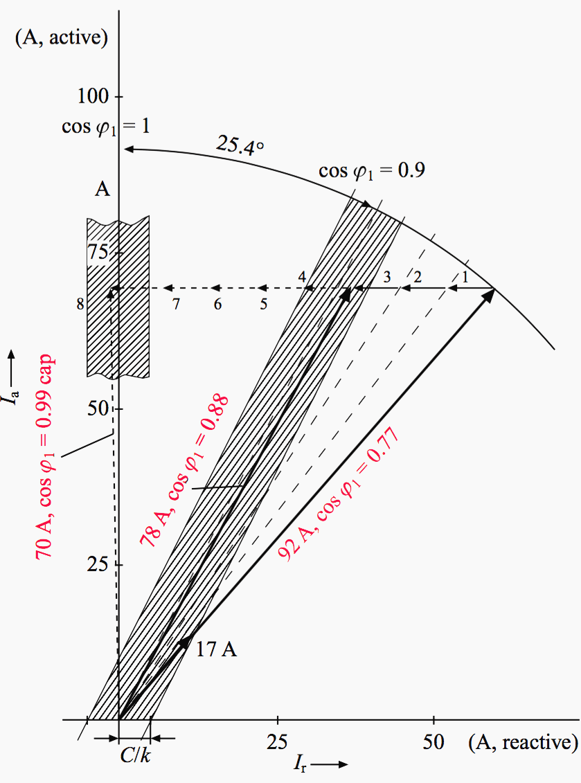

Another situation it is essential to mention is the case when one power transformer, for example no. 3, is out of operation due to maintenance and, provided that the coupling circuit breakers are closed of course, that the power factor relay of compensation C is energized but does not get any signal from the current transformer.
Function between cos φd line and C/k line
Figure 3 – Function between cos φd line and C/k line
With regard to Figure 3 there is no vector existing that exceeds the C/k threshold level. Older relays would ‘stand by’ with the number of capacitors switched in as before. They would not be able to establish control until maintenance is finished.
Not all brands of power factor relays have the capability to disconnect the capacitor(s) after a defined measurement time of ‘no current’ or ‘I = 0’ is displayed. Thus it is essential to get information on this from the manufacturer.
