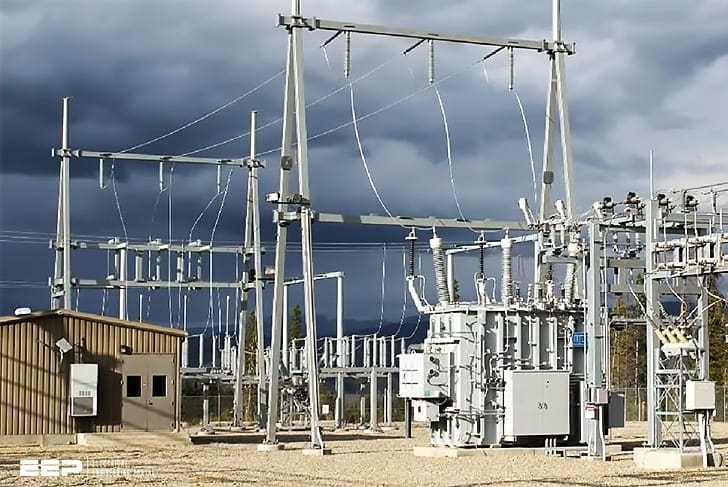

For small distribution substations, this equipment can usually be contained in weatherproof enclosures or control cabinets. For larger substations, separate equipment housing is necessary.
A control house provides a weatherproof and, if required, environmentally controlled enclosure for supplemental substation equipment. Additional space can be provided for workshops, equipment testing and repair, storage areas, and lavatory facilities.
MV and LV switchgear can also be contained within control houses, or this equipment may be contained within weatherproof enclosures dedicated to that purpose.

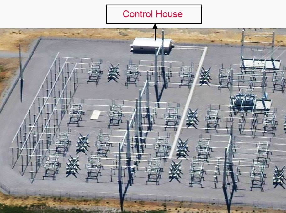

Location of control house in power substation
Figure 1 – Location of control house in power substation

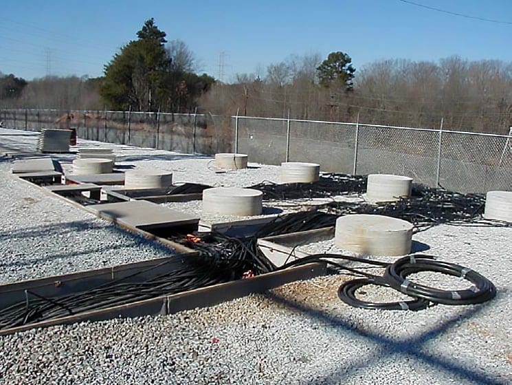

New control house piers poured and cables installed before the control house arrives
Figure 2 – New control house piers poured and cables installed before the control house arrives

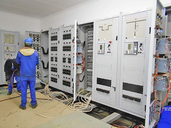

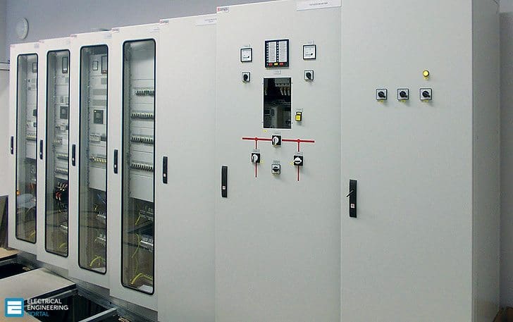

Most protection relaying, metering, and control equipment is mounted on fabricated control and relay panels installed within the control house. A variety of panel types is available to suit individual requirements.
Figures 4, 5 and 6 show examples of various panel layouts.
Control and protection panels
Figure 4 – Control and protection panels
Single vertical panels can be used, particularly for distribution circuits where space requirements are minimal. The relaying, metering, and control equipment can all be mounted on one panel, allocating a separate panel for each circuit. In some instances, two circuits may share the same panel.
Double or duplex panels are commonly used for higher voltage circuits, necessitating additional space for equipment mounting. Normally, these panels are arranged in two parallel rows with the panel backs facing each other. In this configuration, operating, instrumentation, and control equipment for a circuit is installed on the front of one panel, and the corresponding relaying equipment for the same circuit is installed on the front of the panel directly to the rear.
Protection relay panel
Figure 5 – Protection relay panel (photo credit: pestech.com.my)

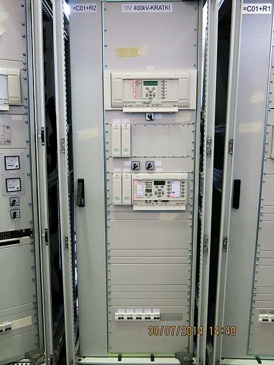

Individual three-phase microprocessor relays can replace three single-phase electromechanical relays and associated voltage, current, and power meters, all in one case.
Compact relay and programmable logic controller designs can be mounted on 48.26-cm (19-inch) racks.
Relay protection panels in control room
Figure 6 – Relay protection panels in control room (photo credit: Protection Installation Services Ltd)

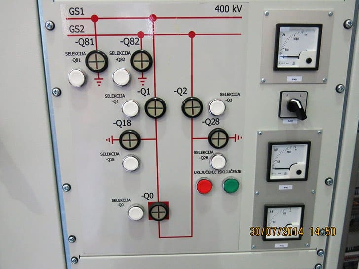

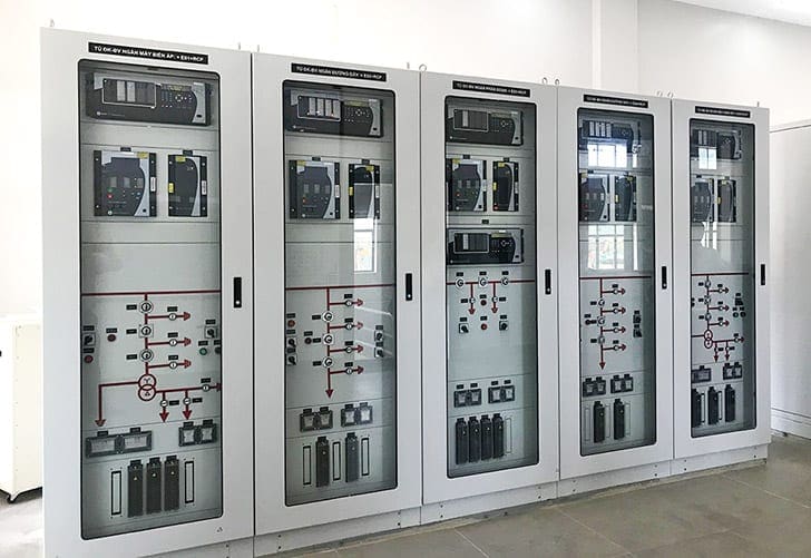

To facilitate operation, panels are located in an arrangement that conforms as closely as possible to the actual equipment and circuit layout in the substation yard. To assist in circuit location and operation, mimic buses are sometimes used on the control panels, particularly for large complex substations.
The mimic buses identify the bus and circuit arrangements.
Mimic diagram in protection relay panel
Figure 7 – Mimic diagram in protection relay panel (photo credit: Edvard Csanyi)
Mimic buses may be implemented on screens viewed from a PC monitor. When practical, position meters at eye level and switches at a convenient operating level. Locate recording meters for ease of viewing and chart replacement.

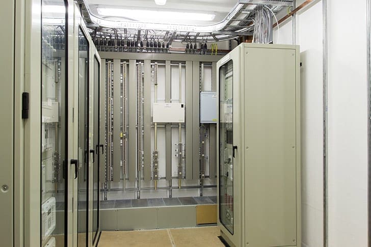

Panel wiring is accomplished on the backs of the panels. Devices are interconnected and wired to terminal blocks, as required, for operation and connection to devices on other panels.
Panels can include small sections perpendicular to the main section at each end for installation of terminal blocks, fuse blocks, or small auxiliary devices.
Cable connections from the equipment in the substation yard can be made directly to terminal blocks mounted on the panels or to strategically placed terminal cabinets. Interconnections between the terminal cabinets and the panels can then be made with single conductor wire.
Cabling of relay protection panels
Figure 9 – Cabling of relay protection panels

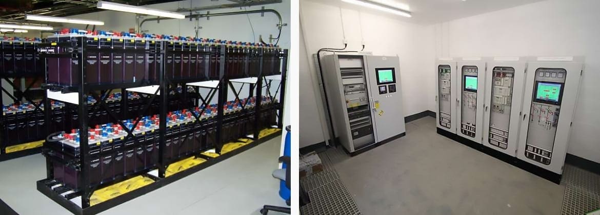

2.2 DC Equipment
Substation DC equipment located in the control house normally consists of the battery, battery charger, monitoring and control devices, and distribution panelboard.
The battery should be located in a separate room where practical. If the battery cannot be located in a separate room, it should be located so that electrical switching devices and receptacles are not in the immediate vicinity, ventilation is adequate to prevent gas accumulation, and live parts are protected from accidental contact.
The battery charger, monitoring and control devices, and distribution panelboard are normally located in the control and relay room to facilitate cable routing and equipment maintenance.
Detailed design requirements and procedures for the substation DC system can be found in this technical article.
Left: Battery room; right: Battery chargers
Figure 10 – Left: Battery room; right: Battery chargers

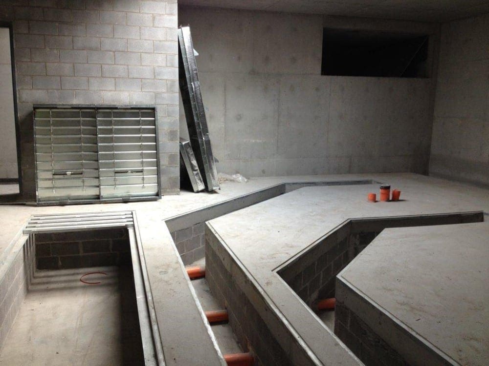

2.4.1 Cable Trenches
Cable trenches are formed into the concrete floor slab and are covered with metal plates. The covers should be flush with the finished floor when in place.
The sizes and locations of the cable trenches are based on the quantities of cables and locations of panels and equipment to be interconnected. Usually, a cable trench is located adjacent to the backs of the control and relay panels to facilitate panel interconnections.
With duplex panels, it may be desirable to use the entire space between the front and rear panels as cable trench, depending on circuit quantities.
Concrete cable trenches in control house
Figure 12 – Concrete cable trenches in control house

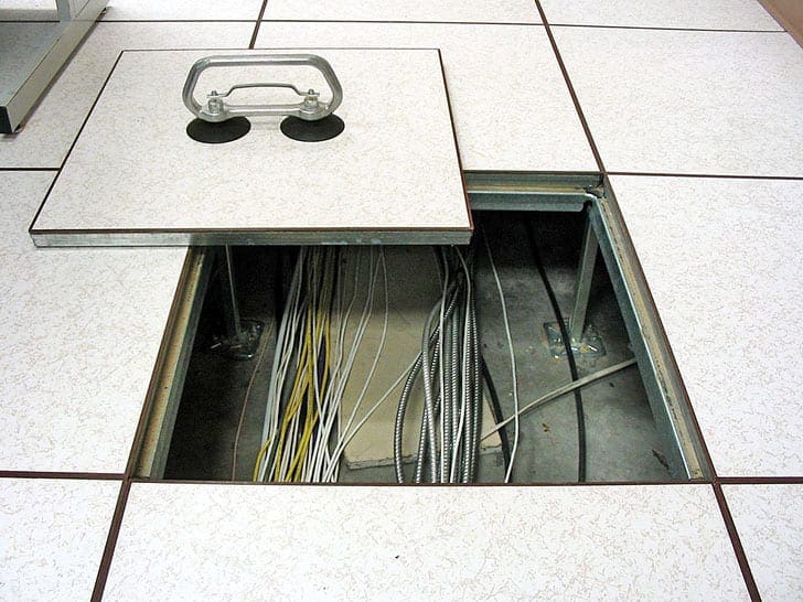

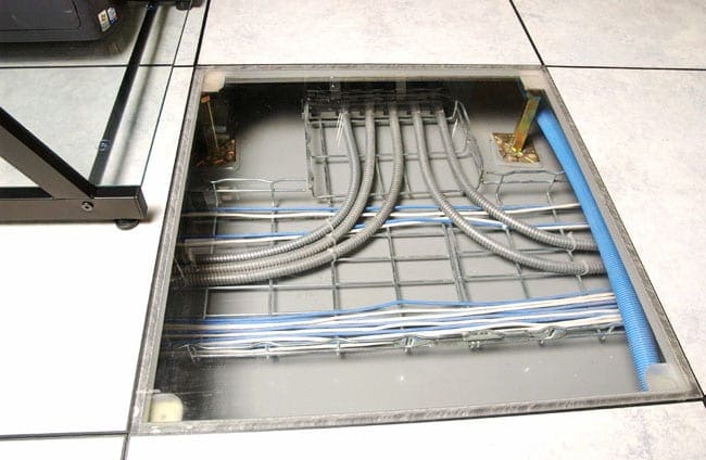

2.4.2 False Floors
False floors are useful when large open areas are desirable for cable routing. Lightweight removable floor panels installed on adjustable pedestals are positioned in areas requiring extensive cable interconnections or where future plans dictate a large amount of cable rerouting.
The top of the removable panels should be flush with the finished floor.
When cables are mounted under false floors, establish routes and paths in which cables should be routed. This will allow the separation of circuits as required to maintain system reliability based on duplicate circuits.
If circuits in one area are damaged, other undamaged circuits in the other parts of the building are likely to keep the substation in service.

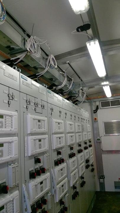

2.4.5 Cable Trays
Cable trays can be used for overhead routing of cables to and between control and relay panels. Expanded metal or ladder-type trays provide the best facilities for conductors entering and leaving the trays.
An advantage of cable trays is the ability to lay rather than pull in the conductors. Suspended cable trays, however, prevent extensive use of this technique because of support locations.
A large variety of types, sizes, and fittings is available to suit individual requirements. Cable tray should be selected and installed in accordance with the NEC and NEMA Standards.
Cables in trays entering panels
Figure 15 – Cables in trays entering panels

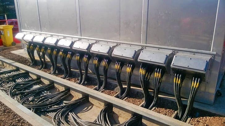

2.5 Cable Entrance
Control and power cables are brought into the control house through windows, sleeves, or cable pits. The windows are square or rectangular openings, usually through the foundation wall but possibly above grade.
The window openings enable many cables to be pulled without interference. To protect the cables during pulling, the windows should have smooth surfaces and beveled or rounded edges. After cable pulling, split sleeves can be installed around the cables and grouted into place.
Occasionally, the windows are left open to facilitate future cable installation. Heat loss through these openings should be considered. Provide additional windows for installation of future cables. The windows can be constructed and bricked up to be opened when required.
Cable sleeves can be used above or below grade. The sleeves are usually cast into place during construction of the foundation wall or installed during construction of the superstructure.
Pitch the sleeves to drain out of the building. Provide covers over the cables. Install spare sleeves during initial construction.
Cable pits may be cast-in-place concrete or masonry openings through the control house foundation to permit access to the inside at floor level. Install a cover over the pit and provide a means to drain water.
Cables entries in control house
Figure 16 – Cables entries in control house

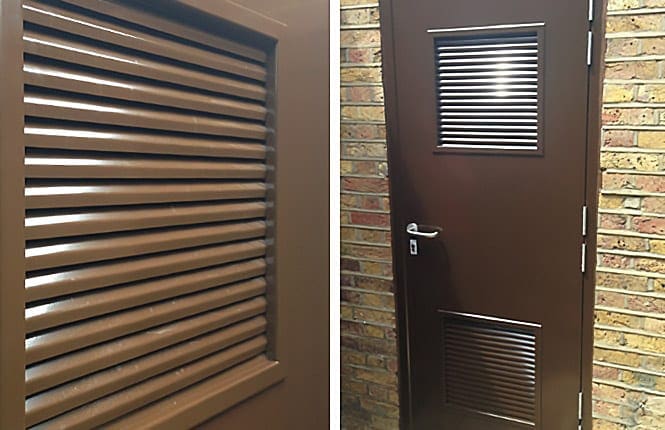

Louvers to achieve good air circulation
Figure 17 – Louvers to achieve good air circulation
Most stations will be unattended and, therefore, a normal personal comfort level is not required. However, for maintenance reasons, comfort levels are necessary.
If the control house is to be heated only, it is usually desirable to install power ventilation equipment for air circulation. Size the system for three to five air changes per hour. Place power-operated, thermostatically controlled roof ventilators and manually operated wall louvers to achieve good air circulation.
Position wall louvers so that equipment does not interfere with air circulation. Provide fusible links to close the louvers in case of fire.
It is advisable to provide ventilation that will maintain a positive pressure within the control house at all times to prevent dust from entering through doors and other openings, and prevent accumulation of combustible gases.
If control house air conditioning is used to provide positive air pressure, then the vent should remain open and fan should run continuously. This also applies if the unit is a heat pump.
The isolated battery room should be equipped with a gravity roof ventilator to remove corrosive and combustible gases. Do not use power-operated roof ventilators.
