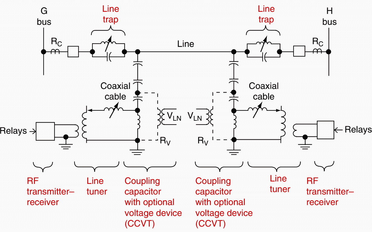

Beginning in the early 1930s radio frequencies between 50 and 150 kHz were superimposed on the power lines for pilot protection. They were originally used in an on–off mode and, as the art progressed, frequency-shift became available.
These are known as power-line carrier channels (PLCC) and are in wide use with frequencies between 30 and 300 kHz. Figure 1 illustrates a typical channel of this type.
In the United States, phase-to-ground coupling is most commonly used. Other types used are phase-to-phase, two-phase-to-ground, and so on. The transmitters generate about 1–10 W of radiofrequency (RF) power.
In the past, 100 W transmitters were available, but they are not in common use currently. The RF signal is connected to the high-voltage line through a line tuner and coupling capacitor, as shown. The tuner, normally mounted at the base of the coupling capacitor unit, cancels the capacitance of the coupling capacitor unit.
This provides essentially a low-impedance resistive path for efficient transfer of RF signals to and from the line section.
Typical single-line diagram for a phase-to-ground power-line carrier channel
Figure 1 – Typical single-line diagram for a phase-to-ground power-line carrier channel
At the remote end, the RF energy passes through similar equipment to the receiver. The transmitter–receiver may be tuned to the same frequency or to different frequencies, which may require a double-frequency tuner.

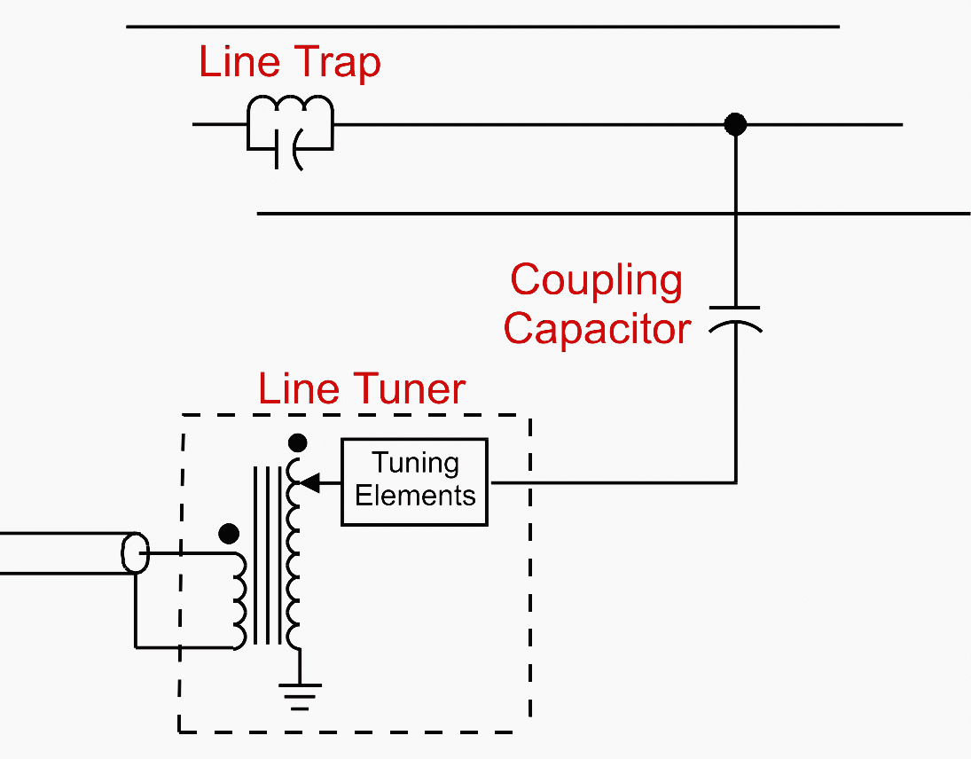

The inductance between the coupling capacitor and ground presents a high impedance to the RF signal, but low impedance to the system 50 or 60 Hz. This unit may also supply secondary voltage as Coupling capacitor voltage devices (CCVTs), in which case, three are used to connect individual phases, and only one is used for coupling, as shown.
A line trap is connected in the high-voltage line at each terminal just external to the RF path. It is tuned to provide a high RF impedance, to minimize signal loss into the buses and associated systems, and to prevent external ground faults from potentially shorting out the signal.
Traps are available for tuning to a single frequency, double (two) frequencies, or to a broad band of RF frequencies. They are designed to carry a 50 to 60 Hz-load current continuously at low loss, and to withstand the maximum fault current that can pass through the line.
Single Phase-to-Ground (Center Phase) Coupling
Figure 2 – Single Phase-to-Ground (Center Phase) Coupling
Although the RF signal is introduced to one of the phases, it is propagated by all three-phase conductors. There have been several occasions when the accidental coupling to different phases at the two terminals has gone unnoticed for several years because an adequate signal was received.
