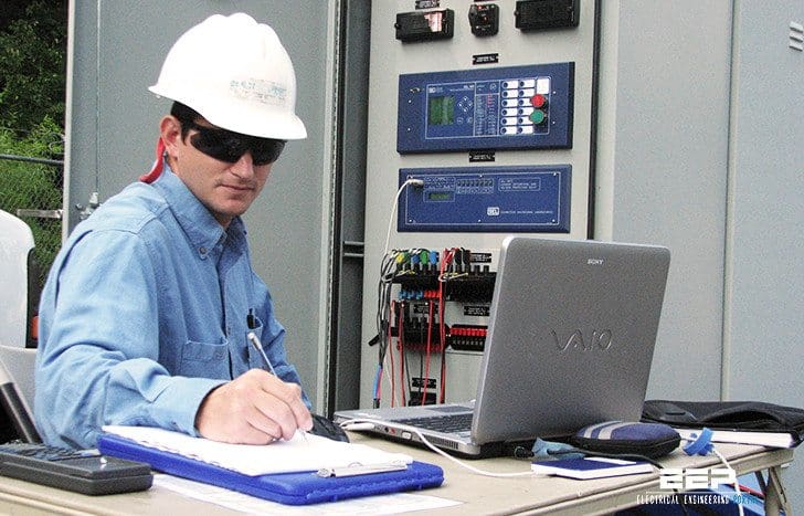

Various tests performed on protection relays (photo credit: canahighvoltage.ca)
