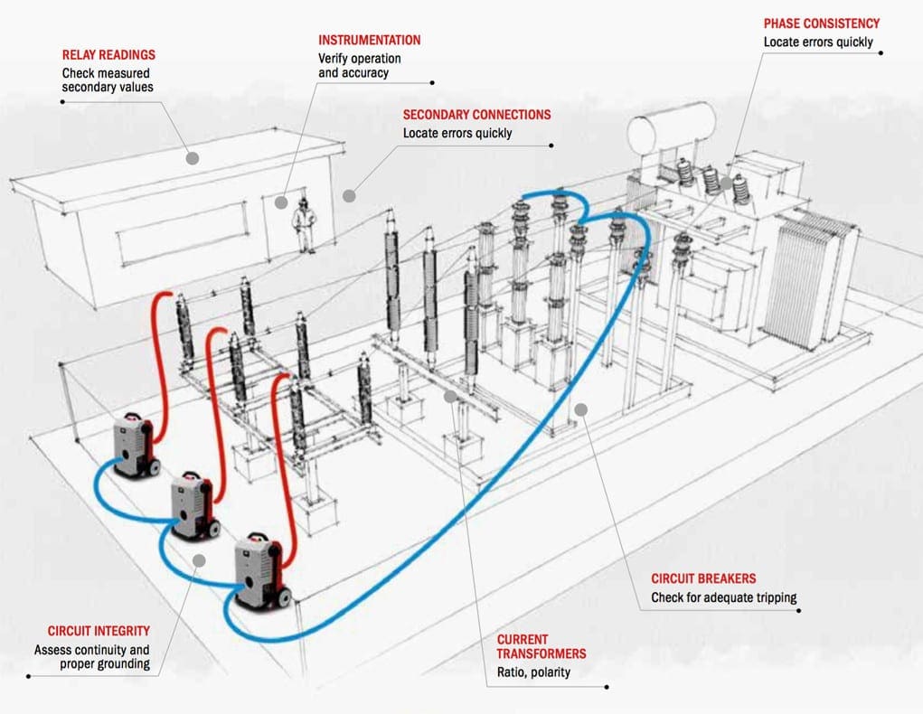

First of all, a STABLE and PRECISE, injection system is required to avoid having to use external primary or secondary measurement instruments. That is, for example, if we are injecting, 300 A to the busbar with an accuracy of around 1%, this will allow us to select the current and go to the substation room, to verify the measurement and the corresponding protection relays readings.
Three-phase primary current injection is performed by SMC’s Triraptor device (see technical details).

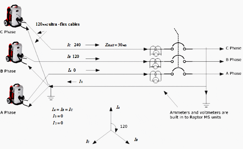

Test circuit for three-phase primary current injection
Figure 1 – Test circuit for three-phase primary current injection – To check the saturation point (Knee point) of each the CT, it is required that there is no uncontrolled saturation in high current faults. The verification of the real load values (Burden) is connected to the secondary circuit and confirms that the CTs are not designed for lower loads than actually exist.
In order to increase the efficiency of this verification, it is necessary that the current injection is in THREE-PHASE mode, for two fundamental reasons:
Reason #1 – One is by short-circuiting one end of the three busbars and connecting it to ground or having a return conductor.
Also the current injector equipment has a control that sets the three- phase situation (120° between phases) and that the same current value is selected in each. This is an advantage in using all its power in feeding the busbar, since the return current through the short circuit is very small, practically zero.
With very long busbars, this allows to a sufficient test current, since the return current is saved.
Reason #2 – The other reason why an accurate and stable three-phase injection is fundamental, is that it allows to take the necessary time to verify the relay properly with all the measurements, both absolute measurements (phase angle) and relative measurements (the comparisons between the different phases) at same time.
In these conditions, a three-phase injection with accuracy and stability, there is nothing that prevents us to select slightly different injection values per phase, for example, if you want to be injecting 300 A each busbar, we can select 300 Amps in phase A, 305 Amps in phase B and 295 A in phase C, this will help to identify which of the phases are connected to the protection relay in the secondary circuit.
The phase angles reading identifies both the polarity and the correct connection to the relay.
Another great advantage of this injecting system, is that we can also combine this with the digital relays installed, so that the display reading, recording and and consequently making a report.
This is fundamental in saving time as this report is practically automatic, by using the configuration program of the relay itself. In addition, the injection equipment also produces its own report of magnitudes injected, phase angles, the duration, etc.
In short, in a single test operation, we can get a complete report of the busbars, both the secondary connection state and of the protection relays in the system. All this is achieved in a quick and easy way compared to the systems that are presently used for these tests.

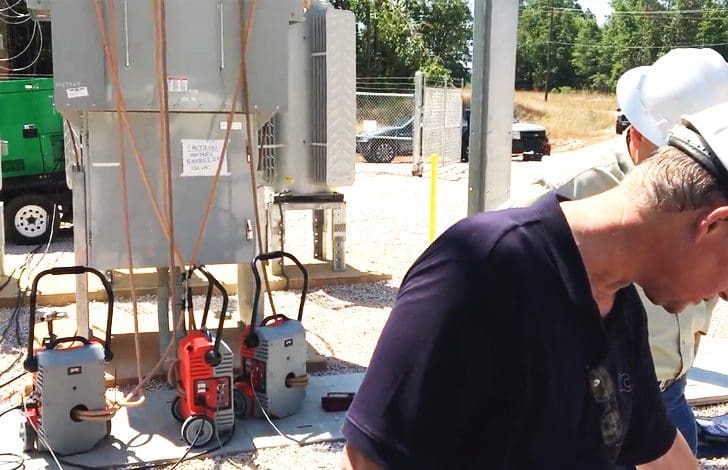

Connect the TriRaptor
Connect the TriRaptor’s three-phase output to both ends of a busbar and let it maintain a pre-defined test current while you browse the entire installation for inaccuracies and possible connection mistakes, quickly and safely, using harmless voltage.
