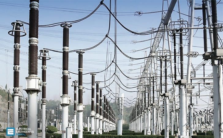

Capacitive voltage transformers (CVTs) are used on higher voltage levels, starting from 66 kV and upwards. The type of the CVT is always a single-pole one, thus the connection is between phase and earth. The higher the voltage level is, the more price-competitive the capacitive type becomes.
HV Capacitive Voltage Transformers
HV Capacitive Voltage Transformers (photo credit: gegridsolutions.com)
One of the advantages the capacitive type has, in comparison to the inductive type, is the possibility to use capacitive voltage transformers as high-frequency coupling units towards the primary system (over headlines).
A typical application would be to utilize the CVTs for power line carrier (PLC) high-frequency signal interface units. For the voltage measurement purposes, the behavior and the data specification of CVTs follow the same guide lines as the inductive ones.
In addition, the possibility for high-frequency signal coupling calls for a specified value for rated capacitance (Cn).
