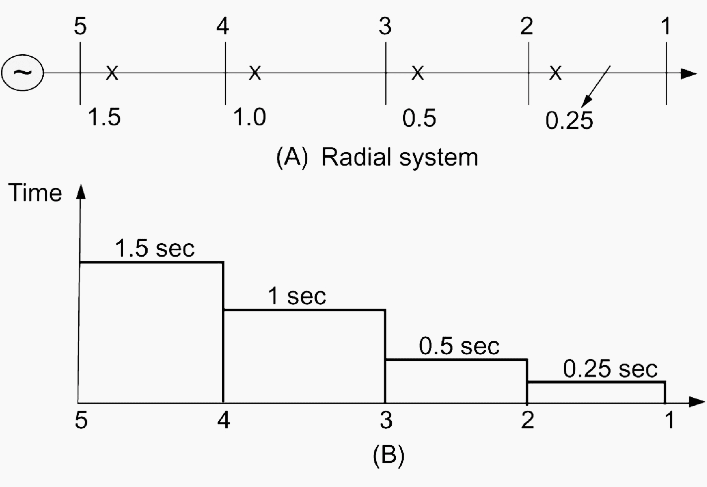

Time grading ensures that the breaker nearest to the fault opens first, by choosing an appropriate time setting for each of the relays. The time settings increase as the relay gets closer to the source. A simple radial system shown in Figure 1 demonstrates this principle.
Principles of Time Grading
Figure 1 – Principles of Time Grading
A protection unit comprising a definite time-delay overcurrent relay is placed at each of the points 2, 3, 4, and 5. The time-delay of the relay provides the means for selectivity. The relay at circuit breaker 2 is set at the shortest possible time necessary for the breaker to operate (typically 0.25 second).
The relay setting at 3 is chosen here as 0.5 second, that of the relay at 4 at 1 second, and so on. In the event of a fault at F, the relay at 2 will operate and the fault will be isolated before the relays at 3, 4, and 5 have sufficient time to operate.
The shortcoming of the method is that the longest fault-clearing time is associated with the sections closest to the source where the faults are most severe.

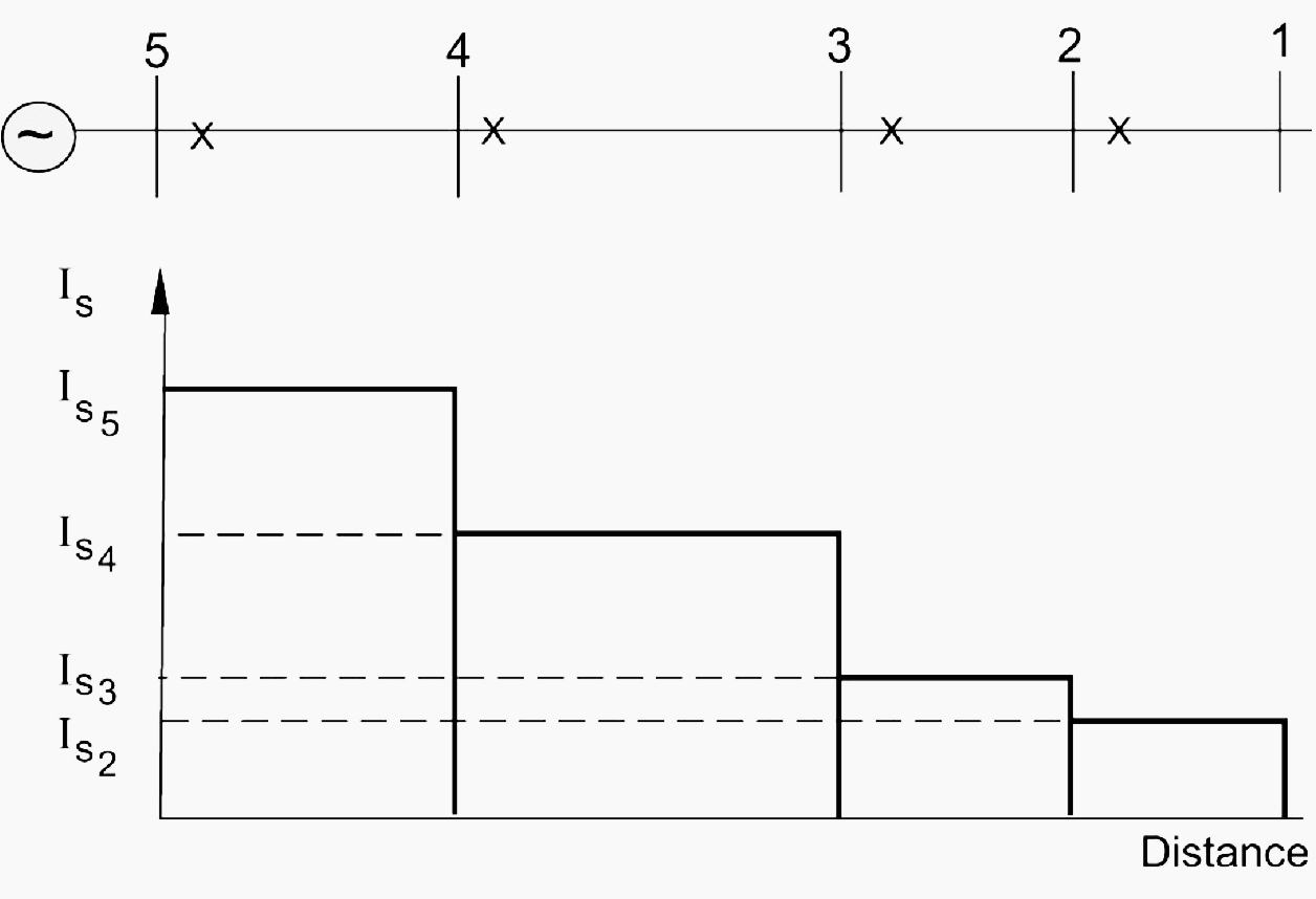

Fault currents are higher the closer the fault is to the source and this is utilized in the current-grading method. Relays are set to operate at a suitably graded current setting that decreases as the distance from the source is increased.
Figure 2 shows an example of a radial system with current grading. The advantages and disadvantages of current grading are best illustrated by way of examples.
Current Grading for a Radial System
Figure 2 – Current Grading for a Radial System

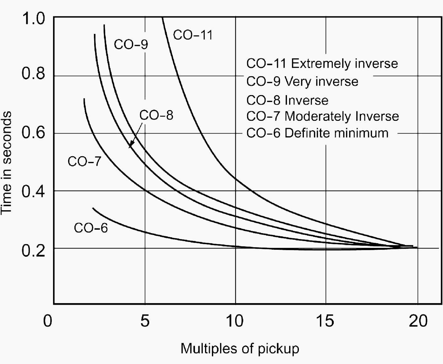

The inverse-time overcurrent relay method evolved because of the limitations imposed by the use of either current or time alone. With this method, the time of operation is inversely proportional to the fault current level, and the actual characteristics are a function of both time and current settings.
Figure 3 shows some typical inverse-time relay characteristics.
Comparison of CO Curve Shapes
Figure 3 – Comparison of CO Curve Shapes

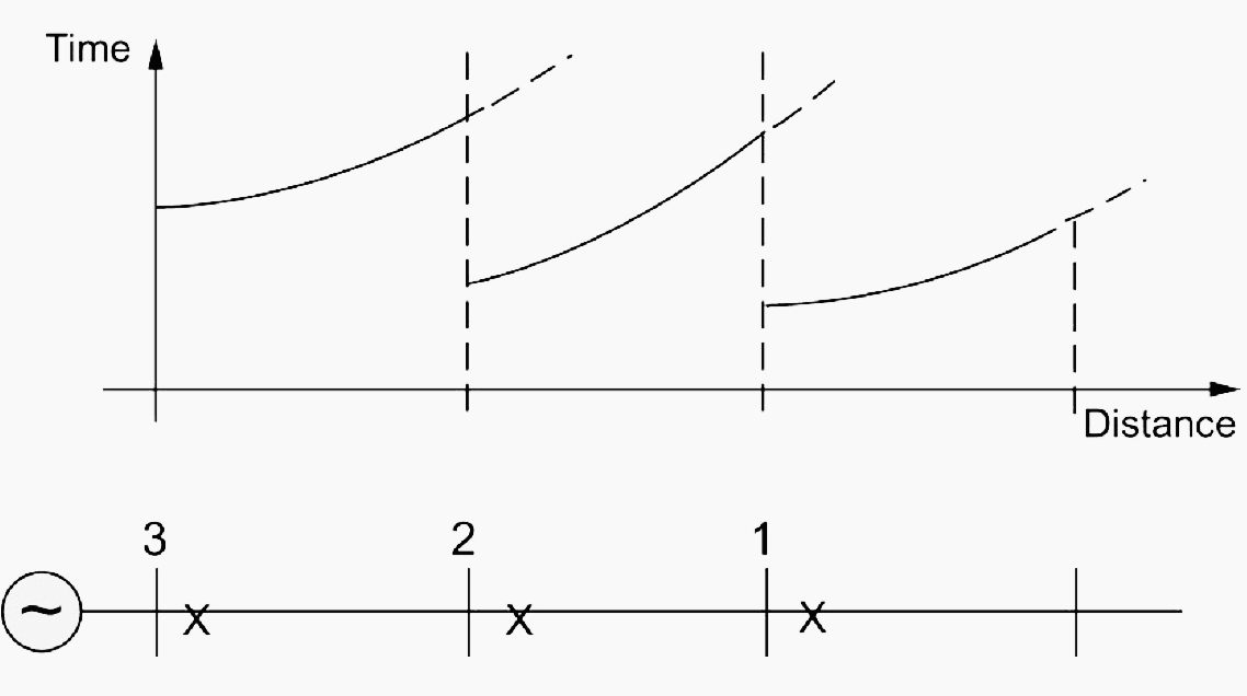

Relay type CO-7 is in common use. Figure 4 shows a radial system with time-graded inverse relays applied at breakers 1, 2, and 3. For faults close to the relaying points, the inverse-time overcurrent method can achieve appreciable reductions in fault-clearing times.
Time-Graded Inverse Relaying Applied to a Radial System
Figure 4 – Time-Graded Inverse Relaying Applied to a Radial System

The time characteristics are plotted in terms of time versus multiples of current tap (pickup) settings, for a given time dial position.
There are five different curve shapes referred to by the manufacturer:
  • CO-11 Extreme inverse
  • CO-9 Very inverse
  • CO-8 Inverse
  • CO-7 Moderately inverse
  • CO-6 Definite minimum
These shapes are given in Figure 3 above.

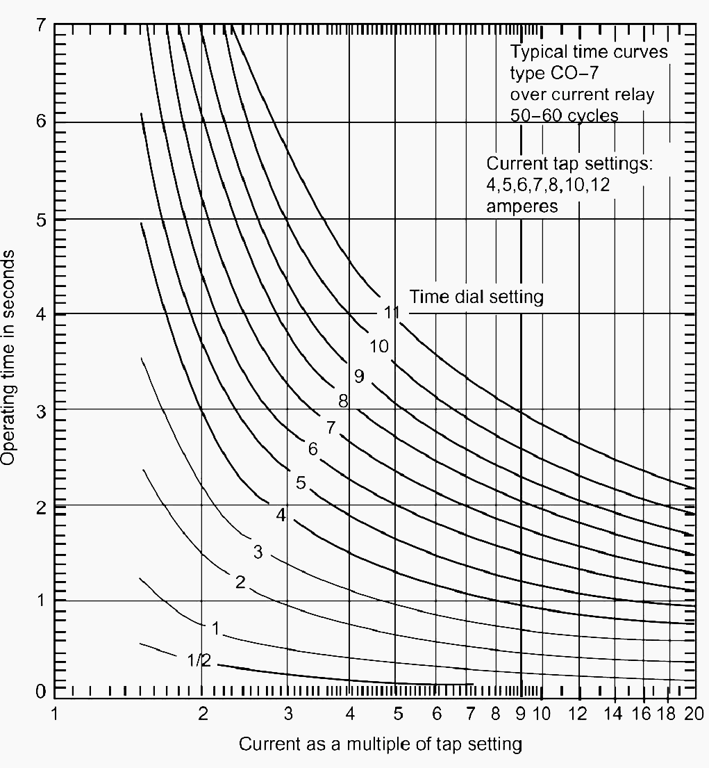

Consider the 11 kV radial system shown in Figure 5. Assume that all loads have the same power factor. Determine relay settings to protect the system assuming relay type CO-7 (with characteristics shown in Figure 6) is used:
An Example Radial System
Figure 5 – An Example Radial System
CO-7 Time-Delay Overcurrent Relay Characteristics
Figure 6 – CO-7 Time-Delay Overcurrent Relay Characteristics

We can now obtain the current tap settings (C.T.S.) or pickup current in such a manner that the relay does not trip under normal currents. For this type of relay, the current tap settings available are 4, 5, 6, 7, 8, 10, and 12 amperes.
For position 1, the normal current in the relay is 5.25 A. We thus choose:
(C.T.S.)1 = 6 A
For position 2, the normal relay current is 8.53 A, and we choose:
(C.T.S.)2 = 10 A
Similarly for position 3,
(C.T.S.)3 = 10 A
Observe that we have chosen the nearest setting higher than the normal current.
The next task is to select the intentional delay indicated by the time dial setting (T.D.S.). We utilize the short circuit currents calculated to coordinate the relays. The current in the relay at 1 on a short circuit at 1 is:
Expressed as a multiple of the pickup or C.T.S. value, we have:
We choose the lowest T.D.S. for this relay for fastest action. Thus:
By reference to the relay characteristic, we get the operating time for relay 1 for a fault at 1 as:
Operating time for relay 1 for a fault at 1
To set the relay at 2 responding to a fault at 1, we allow 0.1 second for breaker operation and an error margin of 0.3 second in addition to T11 . Thus,
The short circuit for a fault at 1 as a multiple of the C.T.S. at 2 is:
From the characteristics for 0.55-second operating time and 6.25 ratio, we get:
The final steps involve setting the relay at 3. For a fault at bus 2, the short circuit current is 3000 A, for which relay 2 responds in a time T22 obtained as follows:
For a fault at bus 2, the short-circuit current is 3000 A
For the (T.D.S.)= 2, we get from the relay’s characteristic,
For the (T.D.S.)2= 2, we get from the relay’s characteristic
Thus allowing the same margin for relay 3 to respond to a fault at 2, as for relay 2 responding to a fault at 1, we have:
Allowing the same margin for relay 3
The current in the relay expressed as a multiple of pickup is:
Thus for T3= 0.90, and the above ratio, we get from the relay’s characteristic,
Setting the relay at 3
We note here that our calculations did not account for load starting currents that can be as high as five to seven times rated values. In practice, this should be accounted for.
