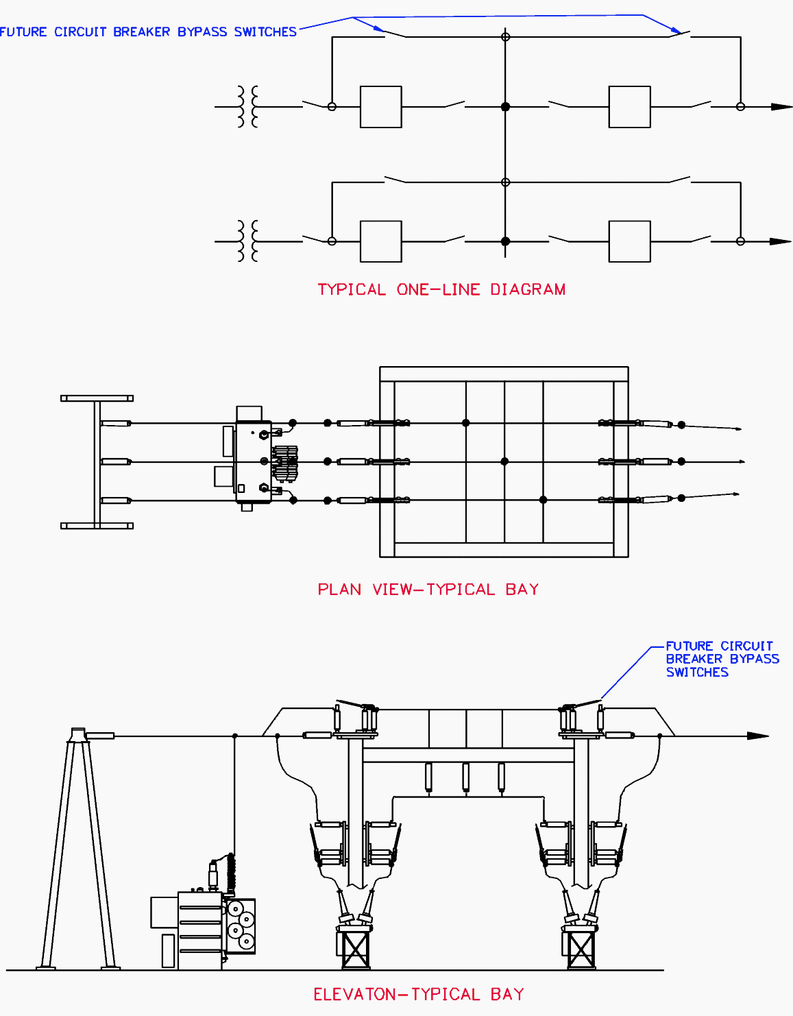

1. Single Bus
A single bus configuration consists of one main bus that is energized at all times and to which all circuits are connected. This arrangement is the simplest, but provides the least amount of system reliability.
Bus faults or failure of circuit breakers to operate under fault conditions results in complete loss of the substation. The single bus configuration can be constructed by using either low- or high-profile structures.
Single Bus - Low Profile Configuration
Figure 1 – Single Bus – Low Profile Configuration
Figure 1 illustrates the single bus arrangement with low-profile structures and presents a neat, orderly plan.
The high-profile design, shown in Figure 2, accomplishes the same purpose and may not require as large a site for a given system voltage.
The single bus arrangement is not recommended without circuit breaker bypass facilities that permit circuit breaker maintenance while maintaining circuit operation.
The high-profile configuration can easily be modified to provide this feature by installing group-operated switches and the associated buswork and connections in the positions shown in Figure 2.
This arrangement, however, results in loss of overcurrent protection for the circuit except by remote circuit breakers during the bypassing operations.
A fault occurring on the line with the breaker bypassed would result in complete substation shutdown. The low-profile arrangement does not allow for future addition of this type of bypassing equipment.

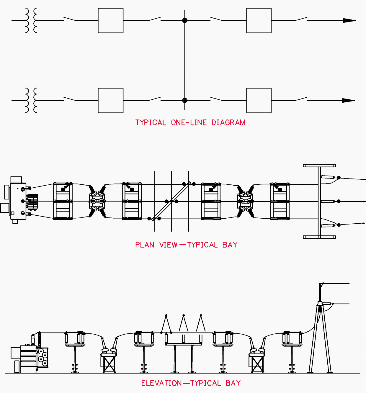

Single Bus - High Profile Configuration
Figure 2 – Single Bus – High Profile Configuration
Consequently, in both low-profile and some high-profile substations, the bypass facilities can be installed outside the substation. Switches can be provided that, when closed, parallel two lines to enable one circuit breaker to be removed from service. The other breaker then protects both circuits.
If this bypassing method is used, the equipment associated with both circuits, have to be capable of carrying the total load of both circuits. If the load is greater than the equipment capability, the load should be reduced.
This method of circuit breaker bypassing may be more desirable in high-profile arrangements than that shown in Figure 2 for lines where frequent or lengthy equipment maintenance is expected.
The high-profile configuration shown in Figure 2 is generally limited to distribution and subtransmission voltage levels. At transmission voltage levels, independent structures and strain bus interconnections are usually used.

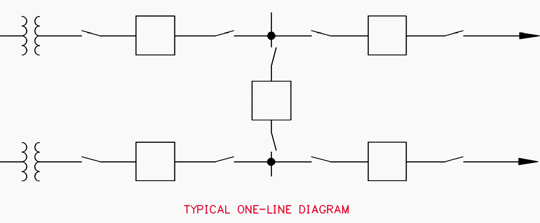

2. Sectionalized Bus
An extension of the single bus configuration is the sectionalized bus arrangement shown in Figure 3. This arrangement is basically two or more single bus schemes, each tied together with bus sectionalizing breakers.
The sectionalizing breakers may be operated normally open or closed, depending on system requirements. In this arrangement, a bus fault or breaker failure causes only the affected bus section to be removed from service and thus eliminates total substation shutdown.
Usually, the fault can be isolated and non-faulted portions of the system restored to service easier and faster because of the increased flexibility of this arrangement.
Sectionalized Bus Scheme
Figure 3 – Sectionalized Bus Scheme
Physically, the equipment can be organized similar to that shown in Figures 1 and 2 for the single bus arrangement.
The sectionalizing breakers and their associated isolation switches are located in line with the main bus. In the high-profile configuration, it is usually desirable to provide a separate bay for the sectionalizing breakers and switches to facilitate maintenance and removal.
The arrangement of lines and transformers in a sectionalized bus arrangement depends on system operating criteria. They should be arranged so as to prevent outage of lines or other circuits dependent on each other.
This can be accomplished by positioning the interrelated circuits on different bus sections to eliminate concurrent shutdown. Perform a thorough analysis of all possible operational contingencies identifying any undesirable conditions preceding the final determination of circuit grouping.
Bypassing arrangements for the sectionalized bus configuration can be provided as explained for the single bus scheme.

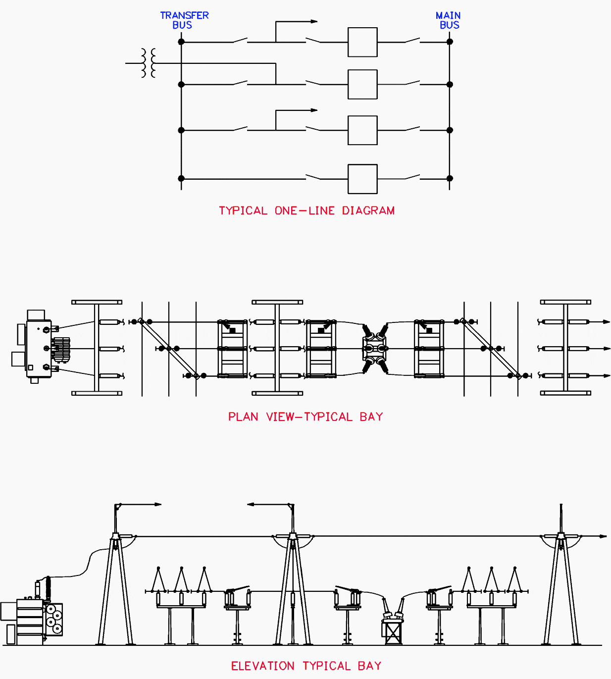

3. Main and Transfer Bus
A main and transfer bus configuration consists of two independent buses, one of which, the main bus, is normally energized. Under normal operating conditions, all incoming and outgoing circuits are fed from the main bus through their associated circuit breakers and switches.
If it becomes necessary to remove a circuit breaker from service for maintenance or repairs, the integrity of circuit operation can be maintained through use of the bypass and bus tie equipment.
The bypass switch for the circuit breaker to be isolated is closed, the bus tie breaker and its isolation switches are closed, and the bypassed breaker and its isolation switches are opened to remove the breaker from service. The circuit is then protected by the bus tie breaker.

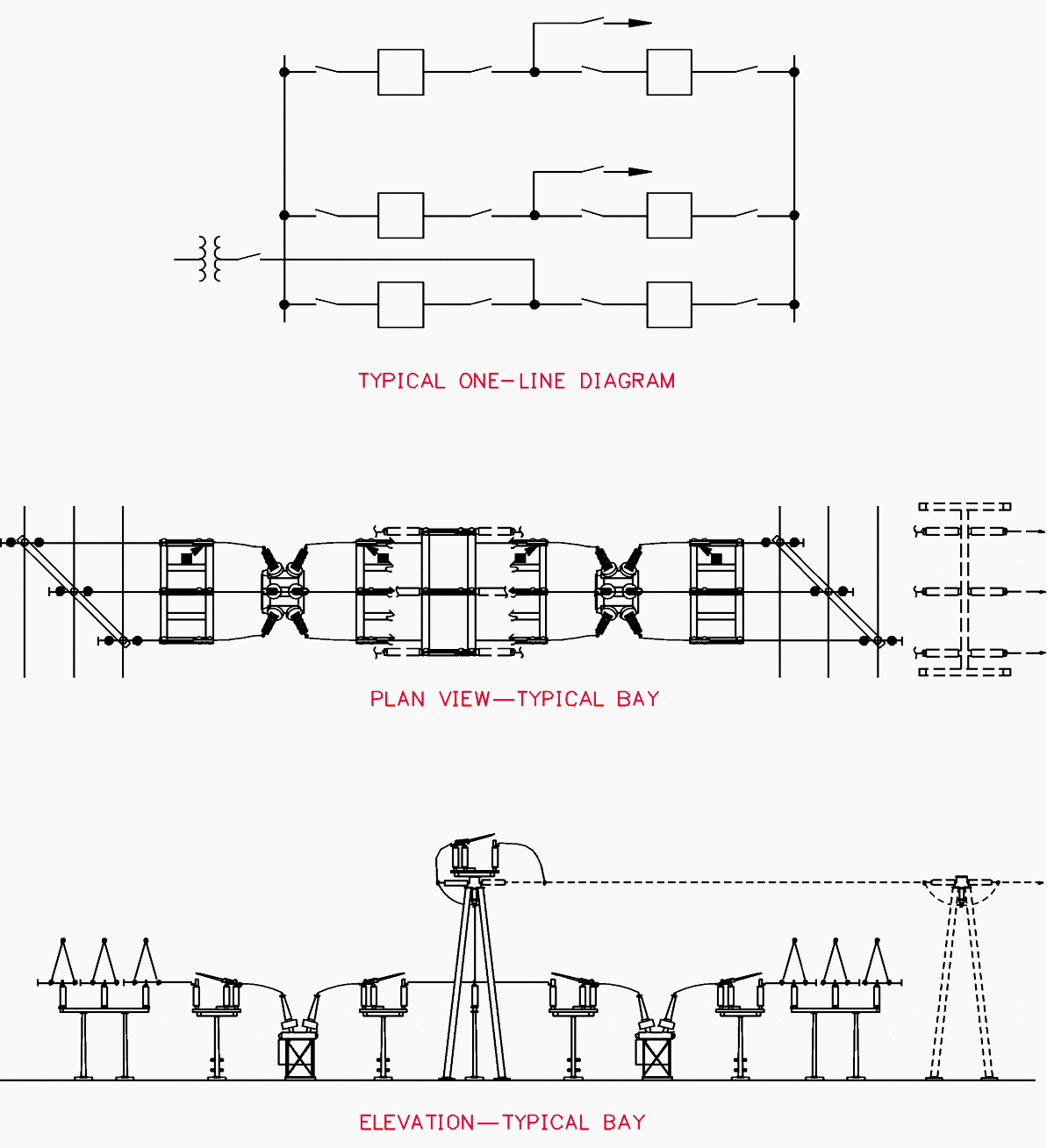

Main and Transfer Bus - Low Profile Configuration
Figure 4 – Main and Transfer Bus – Low Profile Configuration
Figure 4 illustrates a main and transfer bus configuration in a low-profile arrangement. For comparison, Figure 5 shows the same switching scheme with high-profile box-type structures.
With the box-type structure arrangement, two circuit positions can be accommodated per equipment bay.
However, with the low-profile arrangement, each circuit requires its own bay and, as a result, somewhat more land area may be required. When the low-profile configuration is used, equipment bays should be limited in width to a maximum of two bays before the bay-to-bay centerline spacing is increased to accommodate circuit breaker maintenance and removal.
Without the additional space, these tasks can become very difficult.

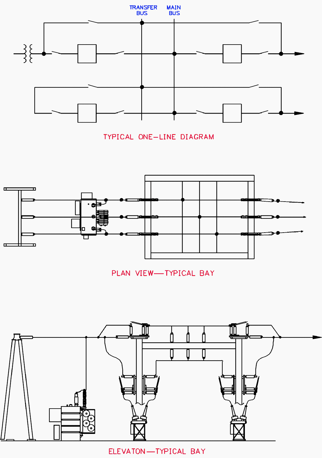

Main and Transfer Bus - High Profile Configuration
Figure 5 – Main and Transfer Bus – High Profile Configuration
The high-profile, box-type structure arrangement shown in Figure 5 can accommodate multiple circuits in a relatively small area. The configuration is particularly suitable in environmentally shielded or otherwise isolated locations, where only a limited substation site is available.
This arrangement is generally limited to distribution and subtransmission voltage levels. At transmission voltage levels, independent structures and strain bus interconnections can be used.

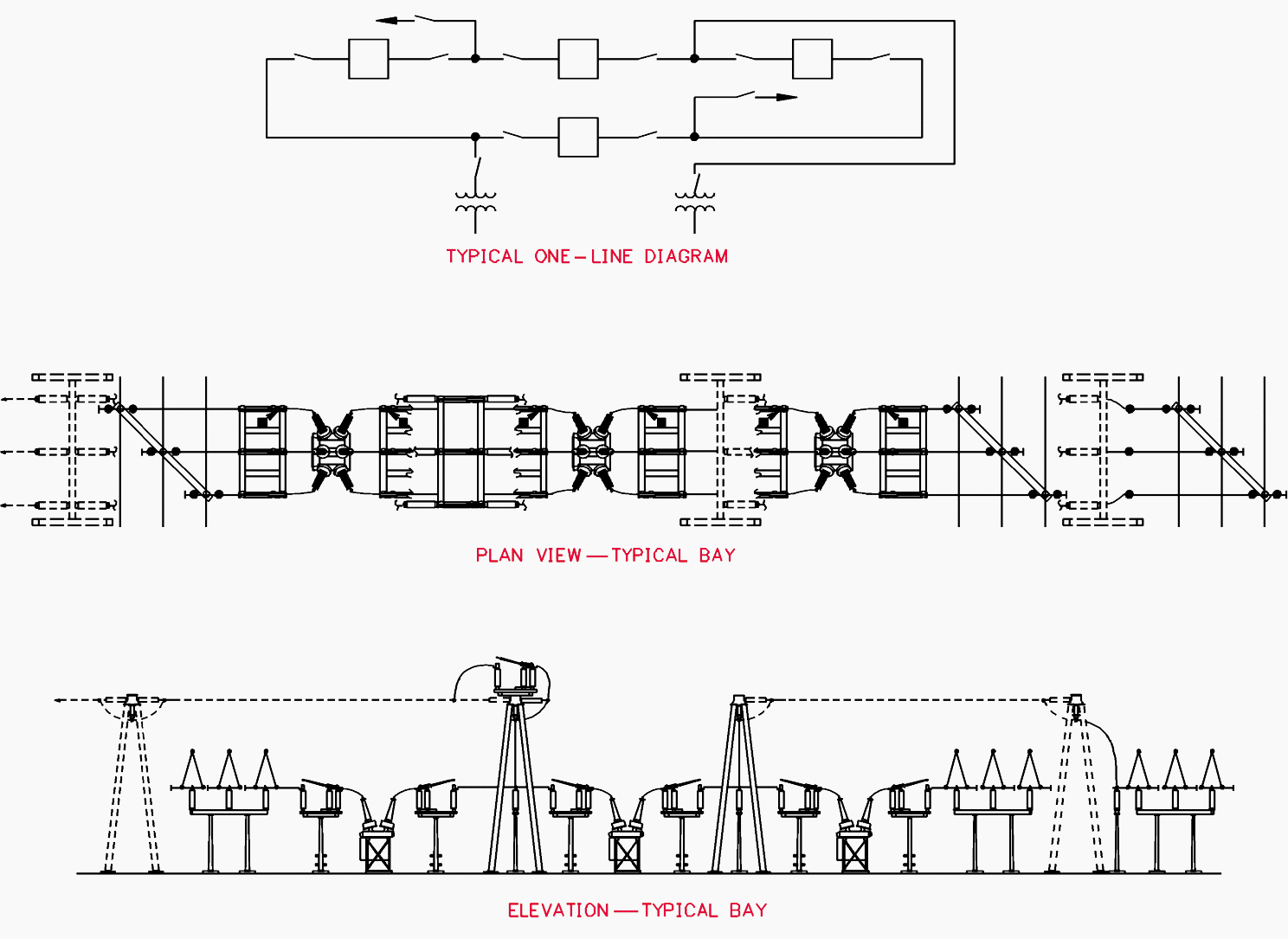

4. Ring Bus
A ring bus configuration is an extension of the sectionalized bus arrangement and is accomplished by interconnecting the two open ends of the buses through another sectionalizing breaker.
This results in a closed loop or ring with each bus section separated by a circuit breaker. For maximum reliability and operational flexibility, each section should supply only one circuit.
In this arrangement, as with the sectionalized bus configuration, only limited bus sections and circuits are removed from service because of line or bus faults or circuit breaker failure. For a line or bus fault, the two circuit breakers on the sides of the affected bus section open to isolate the fault. The remaining circuits operate without interruption.
For a breaker failure, the two breakers on the sides of the affected breaker open, along with a transfer trip to a remote breaker, to isolate the failed breaker and remove two bus sections from service.
The ring bus arrangement provides for circuit breaker maintenance since any breaker can normally be removed from service without interruption of service to any circuits.
As a result, separate circuit breaker bypass facilities are not required.
Ring bus configuration
Figure 6 – Ring bus configuration
A number of equipment arrangements may be used to provide a ring bus configuration, depending on anticipated substation expansion and possible system modifications. Figure 6 illustrates a typical ring bus configuration.
The arrangement shows four circuit positions, which is a practical maximum for a ring bus configuration. Rather than expanding the ring bus to accommodate additional circuits, other more flexible and reliable configurations, such as the breaker-and-a-half scheme, can be adopted.
The ring bus arrangement shown in Figure 6 is readily adaptable in the future to a breaker-and-a-half configuration as shown in Figure 7 below. However, the relay and control panels have to be carefully planned to be modified later for breaker-and-a-half operation.
Bay centerline spacing should be carefully planned to permit equipment maintenance and removal.

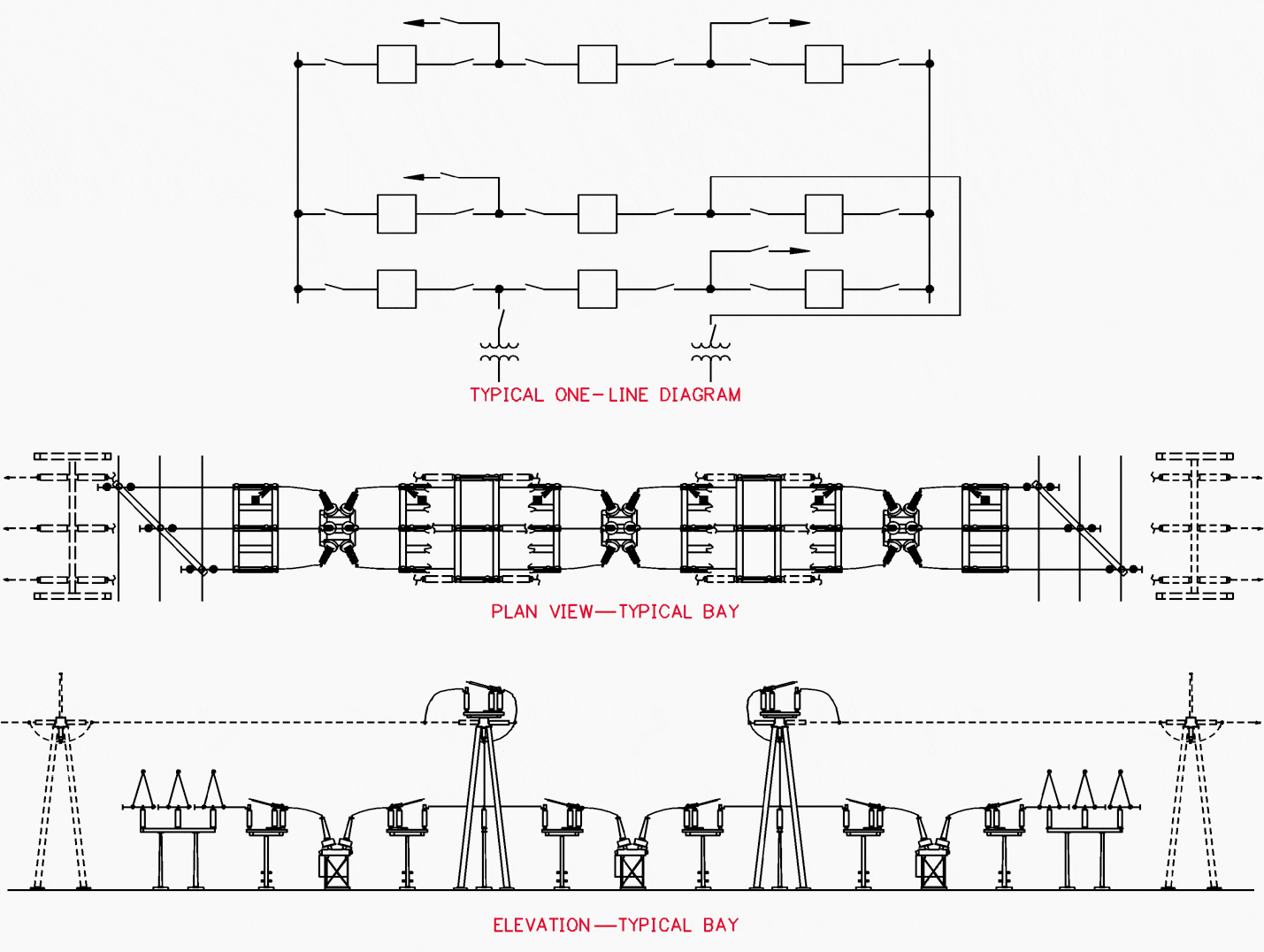

5. Breaker-and-a-Half
The breaker-and-a-half configuration consists of two main buses, each normally energized. Electrically connected between the buses are three circuit breakers and, between each two breakers, a circuit as diagrammed in Figure 7.
In this arrangement, three circuit breakers are used for two independent circuits; hence, each circuit shares the common center circuit breaker, so there are one-and-a-half circuit breakers per circuit.
The breaker-and-a-half configuration provides for circuit breaker maintenance, since any breaker can be removed from service without interrupting any circuits.
Additionally, faults on either of the main buses cause no circuit interruptions. Failure of a circuit breaker results in the loss of two circuits if a common breaker fails and only one circuit if an outside breaker fails.
Breaker-and-a-Half Configuration
Figure 7 – Breaker-and-a-Half Configuration
A typical bus configuration for a breaker-and-a-half arrangement is shown in Figure 7. This is the same basic equipment assemblage as described for the ring bus scheme.
Frequently, substations are initially constructed with a ring bus arrangement and ultimately expanded into a breaker-and-a-half configuration to obtain the additional flexibility and reliability required with the additional circuits.
