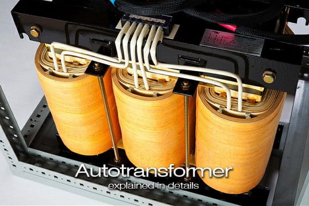

High efficiency autotransformer with 6%, 4%, 2% tap settings
High efficiency autotransformer with 6%, 4%, 2% tap settings (photo by Legend Power)
