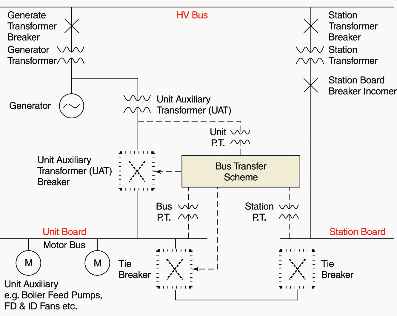

An illustration of the typical arrangement of a unit and station switchgear, and unit to station bus transfer scheme, in a power station, is given in Figure 1.
A typical arrangement of unit and station switchboards, with unit to station bus transfer scheme
Figure 1 – A typical arrangement of unit and station switchboards, with unit to station bus transfer scheme
Scheme explanation
Before the power plant starts generating power, it is required to start-up the auxiliaries like the boiler feed pump, CW pump, etc. During start-up, as the unit is still not generating, the unit switchgear bus is fed from SAT through a tie connection to the station switchgear bus.
Once the unit starts generating power, the unit switchgear bus is disconnected from the station switchgear bus, and starts taking power from the unit itself, through UAT.
Thus the power plant is run from the output of its own generating unit. In case the unit is tripped due to some fault or planned shutdown, the incoming supply to the unit switchgear bus fails. In this condition also, it is essential to keep the power plant auxiliaries in a running condition.
Hence the power supply to the unit switchgear bus is again taken from SAT, through the tie connection to the station switchgear bus.
This is called a unit to station bus transfer.
Once the fault is cleared and the unit starts generating power again, the incoming supply to the unit switchgear bus is again shifted from SAT to UAT, by opening the tie breaker between the station and unit switchgear buses, and closing the incomer from UAT.
This is called a station to unit bus transfer.
Sometimes, due to a fault in one station transformer, it may also be required to shift supply of the station switchgear from one SAT to another, through tie breakers provided between two station buses.
This is called a station to station bus transfer.

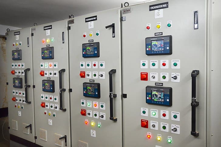

Synchronising panel
Synchronising panel
However, in case of an emergency, when the other modes of bus transfer with voltage interruption are not available, this mode can be adapted with due precautions.

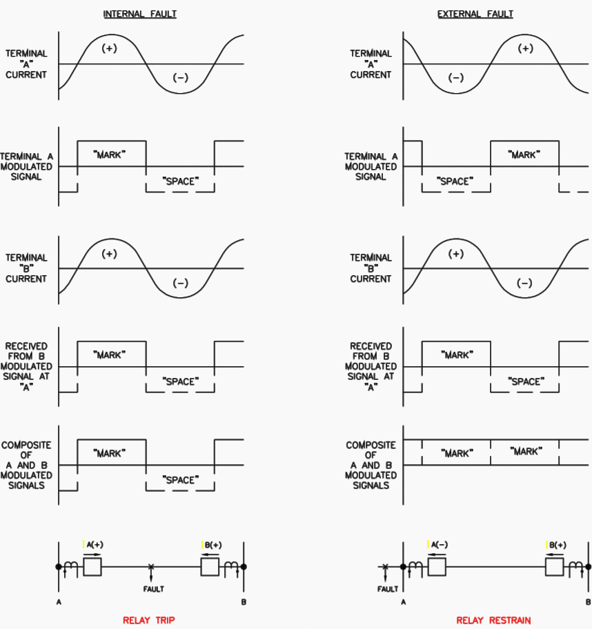

How phase comparison relay works?
In basic phase comparison (PC) protection, the channel does not attempt to send the entire waveform between terminals. Instead, the channel conveys only the phase information regarding the current by sending only one of two states – either the sending end waveform is above the zero axis, or it is below the axis. The same two-state logical determination is made for the local current signal at the receiving terminal.
After delaying the local signal to align with the received signal, the states of the two signals are compared (see Figure 3).
For normal load flow or for an external fault, the situation is as shown on the right. Current flows into one end, and out the other. If the CT circuits are consistently polarized at the two ends, then the local and remote mark signals (positive phase position of respective current signals) have little or no coincidence – if we combine them with an AND gate, its output will be false, or will have at most two short true pulses per power cycle if the current waves are not exactly out of phase.
Basic phase comparison operation
Figure 3 – Basic phase comparison operation
For an internal fault, as shown on the left, current flows into the line from both ends. The local and remote mark signals are now aligned for all or most of the positive half-cycle. The output of the AND gate now comprises a positive or true pulse lasting about one-half cycle, alternating with a false or zero output of the same duration.
If the AND gate output feeds a timer of about one quarter power cycle pickup delay, the output can be used to initiate tripping of the local breaker.
