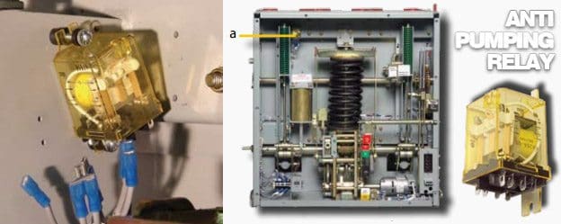

Why Antipumping relay is used?
Anti pumping relaying is done primarily to indicate the spring failure of TNC switch and a person need to attend the problem. The function of this relay is to cut off the supply to 52C (CB closing coil) in case of TNC switch spring failure and prevent CB hunting effect (i.e. continuous closing, opening operation).
Anti pumping is also called trip free mechanism of any circuit breaker. Suppose the breaker has been instructed to close by manual instruction by pressing the TNC (trip neutral close push button) switch. The operating mechanism will start operating for closing operation.
Meanwhile a fault has taken place and relay closes the trip circuit of breaker. The trip free mechanism/ Anti pumping feature permits the circuit breaker to be tripped by protective relay even if it is under process of closing. Thus auxiliary relay (or sometimes the inbuilt feature of circuit breaker) which prevent alternate tripping and closing of the circuit breaker if closing push button is held close during fault is called the trip free mechanism or anti pumping mechanism.

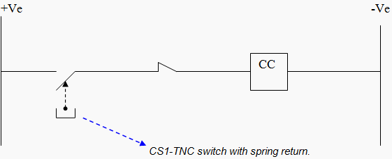

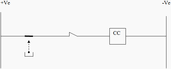

CASE 1: Closing Coil Circuit Without 52 Relay
The path for CB close with out 52 relay is shown in Figure 1. In this case if spring of TNC switch fails, then supply will be get extended to 52C (CB closing coil)  coil as shown in Figure 2.
Figure 1 - Circuit breaker closing coil without Antipumping relay
If the TNC switch spring has failed then supply will be extended as shown below.
Figure 2 - Supply extended to closing coil because of TNC spring failure
Figure 2 - showing how supply will be extended to closing coil because of TNC spring failure

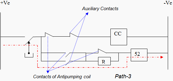

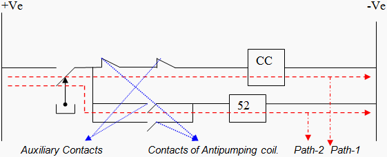

CASE 2: Closing Coil Circuit With 52 Relay
Closing coil circuit with 52 present is as shown in Figure 3. Path 1 in Figure 3 shows how 52C (CB closing coil)  will be energized when we press TNC switch CS1.if CS1 comes to its original state once we release it then 52 will not come in picture. if CS1 does not comes to its original state then 52 will be energized as shown in path 2.then 52-NC contact present in path 1 will be got opened up and prevents extension of supply.
We have the concept that initially for the energization of 52 80% to 90% of 110V is required. But once after energization 60-70% of 110V is sufficient to maintain its energization state. This logic is achieved by introducing a resistance in 52 energization maintenance path. This path is shown in Figure 4.
Figure 3 - With Antipumping relay present
Figure 4 - Antipumping relay with a resistor
Once 52 is energized it will give an alarm and a maintenance person in the substation need to attend that problem. This is how 52 is useful in avoiding CB hunting effect.

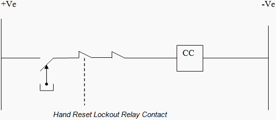

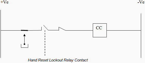

Can we manage without anti pumping since operation of lock out relay would prevent any further operations of CB even continuous opening-closing?
Figure 5 - Antipumping relay & Lockout relay contacts in closing coil circuit
Let us assume that we have closed the circuit breaker using the TNC switch CS1.At this instant TNC switch spring failed and fault is there which is sensed by primary protection relay and sends tripping command to circuit breaker. This would energize the trip coil of breaker; this will result in operation of lock out relay.
The lock out relay will go into lock out state as shown in Figure 6 below:
Figure 6 - The lock out relay goes into lock out state
Now let a person had attended that fault and resetted 86 lockout contacts. After resetting its status will be NC and a closed command will be extended to closing coil without any human interface which is a mal function.
So an 86 lockout relay cannot fulfill the purpose of anti pumping relay.
The function of anti pumping relay is to cut off the supply to closing coil in case of TNC switch spring failure and prevent CB hunting effect (i.e. continuous closing, opening operation) and a person needs to attend the problem. Where as 86 lock out relay contact in closing circuit is meant to ensure that a person had attended the fault occurred and we are closing the circuit after clearing the circuit.
It is extra mechanical protection meant for safety of equipments considering the cost and sophistication involved; it is always advisable to go for extra human interface.
