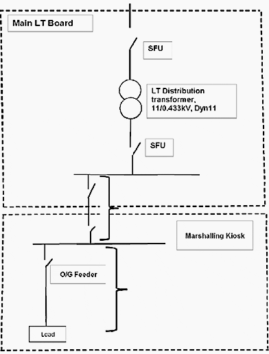

One sample calculation for calculating the short circuit current at downstream of transformer is shown below.
Purpose and intent of this calculation is to calculate the short term current rating of a marshalling kiosk to be fed by AC distribution board (ACDB). ACDB being fed by a source of 630kVA transformer.
Calculation basis
1/ The busbar and switchgear of Marshalling kiosk is sized for short time rating as per contribution from MV source through LT transformer.
2/ For circuits connected by transformer PU system is particularly suitable. By selecting suitable base kV for circuits the per unit reactance and resistance remains same, referred to either side (HV or LV) of transformer.
3/ For circuits connected by transformer same base kVA is selected for both the circuits (HV and LV) because power remains constant throughout so same base kVA should be considered throughout.
4/ As a rule only two bases should be selected first and from these two the remaining bases should be calculated. This is so because kV, kVA, I and Z are interrelated. They must obey ohms law. If we select base kVA and base kV than other base like base I and base Z are calculated from base kV and base kVA.
Vice-versa will be inconvenient that is selecting base I and Z and calculating other bases like kV and kVA will make calculation difficult.

Actual Fault Current available at marshalling kioskbusbar
Busbars and switchgear components of marshalling kiosk shall be braced for the peak value of the faultcurrent contribution from the MV system through 630kVA rated source transformer.
Hereafter Marshalling kiosk to be referred as BMK and AC distribution board to be referred as ACDB.

Fault MVA at BMK busbar = Base MVA/Total Impedance = 0.63 / 0.1842 = 3.42
Fault current in kiloAmps at BMK busbar = Fault MVA x 1000x 1000 / (√3 x 0.415 x 1000 x 1000)
= 3.42 x 1000 x 1000 / (√3 x 0.415 x 1000 x 1000) = 4.757 kA
Hence selection of 10kA busbar and switchgear components like MCB is safe and appropriate as per the actual fault level existing at BMK main busbar.
