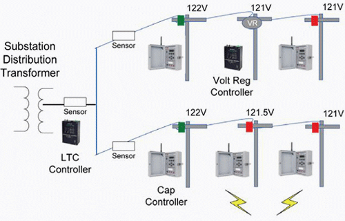

The distribution substation is the electrical hub for the distribution network.
Volt/VAr Optimization
Volt/VAr Optimization (photo credit: ABB Conversations)
A close coordination between the substation equipment, distribution feeders and associated equipment is necessary to increase system reliability. Volt/VAR control is addressed through expert algorithms which monitors and controls substation voltage devices in coordination with down-line voltage devices to reduce line loss and increase line throughout.

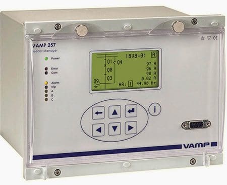

VAMP 257 Feeder manager relay

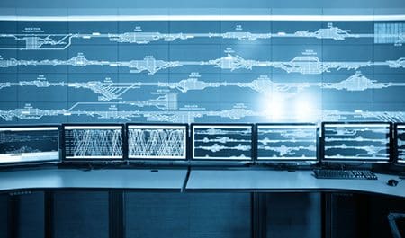

SCADA screen - Public utility
SCADA screen – Public utility
In addition, data acquisition and processing and remote metering functions play a large role in reducing operating costs and should be considered an integral part of any distribution automation system. Through real time operation, the control computer can locate the faults much faster and control the switches and reclosures to quickly reroute power and minimize the total time-out, thus increasing the system reliability.
