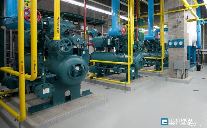

In many buildings, HVAC is the first or second item in terms of energy costs. This technical article deals with optimisation tips and energy efficiency savings in heating systems of a building.
8 Actions to Improve Energy Efficiency In Heating Systems
8 Actions to Improve Energy Efficiency In Heating Systems (on photo: Commercial Building's Heating System; credit: docsavageair.com)
