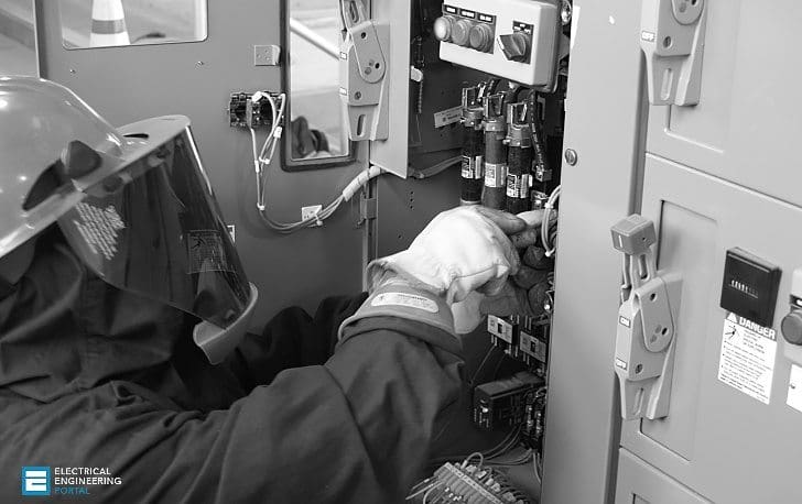

Equipment that has been deenergized and verified as such is said to be in an electrically safe work condition. Article 120.1 of NFPA 70E outlines 6 steps that must be followed to insure that employees are working in an electrically safe work condition.
6 Steps To Establish an Electrically Safe Work Condition
6 Steps To Establish an Electrically Safe Work Condition (photo credit: necanet.org)

It is important to note that a safe work condition does not exist until all 6 steps are complete. During the process of creating the electrically safe work condition, the appropriate PPE must also be utilized.
