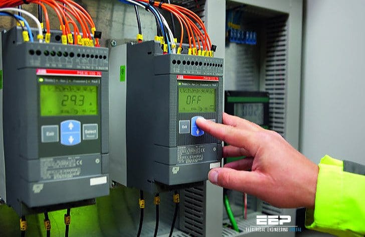

This technical article includes a short description of six common setting parameters available on most of the softstarters. Other settings may be available depending on the type of softstarter and manufacturer.
6 Common Setting Parameters Available On Most Of The Softstarters
6 Common Setting Parameters Available On Most Of The Softstarters (photo credit: ABB)
The setting can be done either by adjusting potentiometers, changing dip switches, using a key pad, a computer or similar and
  1. Start ramp
  2. Stop ramp
  3. Initial voltage
  4. Current limit
  5. Step down voltage
  6. Adjustable rated motor
