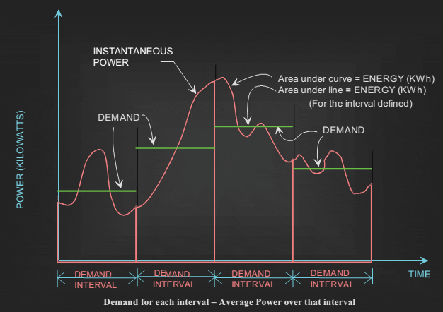

Real power consumption, typically expressed in kilowatts or megawatts, varies instantaneously over the course of a day as facility loads change. While instantaneous power fluctuations can be significant, electric utilities have found that averagepower consumption over a time interval of 15, 30, or 60 minutes is a better indicator of the “demand” on electrical distribution equipment.
Transformers, for example, can be selected based on average power requirements of the load. Short-duration fluctuations in load current may cause corresponding drops in load voltage, but these drops are within the normal operating tolerances of typical machines and within the design parameters of the transformer.
The demand rate, in $/kW, may also be referred to as a capacitycharge, since it has historically been related to the necessary construction of new generating stations, transmission lines, and other utility capital projects. Demand charges often represent 40% or more of an industrial customer’s monthly bill.
“Demand” is the average instantaneous power consumption over a set time interval, usually 15, 30, or 60 minutes.

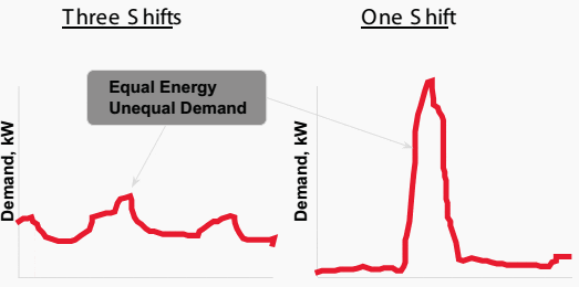

Typical load factor for an industrial facility depends to a great degree on the number of shifts the plant operates. One shift, five-day operations typical record a load factor of 20-30%, while two-shifts yield 40-50%, and three shift, 24/7 facilities may reach load factors of 70-90%.
Graphical comparison of facilities with dramatically different load factors
Graphical comparison of facilities with dramatically different load factors. The three shift facility produces an average demand that is nearly equal to its peak demand, while the average and peak
demand for the one shift facility is much less than one

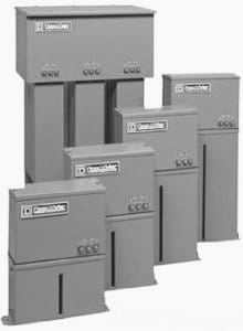

Even if a utility does not charge directly for poor power factor, there are at least three other reasons that a customer may find it economical to install equipment to improve power factor within its facility, thereby reducing the reactive power requirements of the utility.
Fixed capacitors are best suited for use on electrical systems with no voltage or current harmonics
